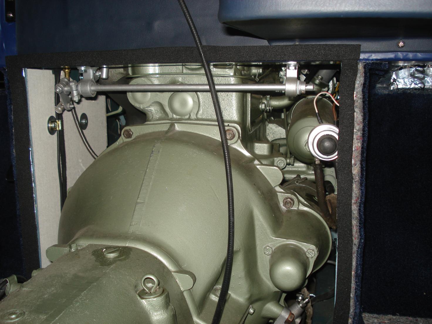

healeyblue
Yes the early cars did not have a hole they just fit between the firewall and the trans cover. I used a foam seal between the two and made a small void just big enough for the speedo cable to fill and it helps the cable to not get so crushed.

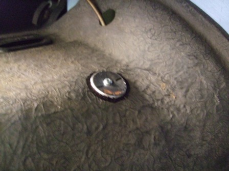

vette
My BJ7. Dave.
