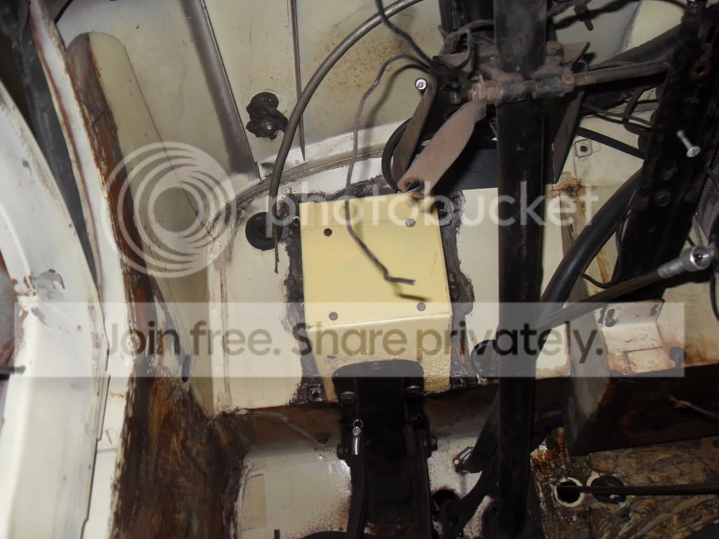

Howdy Folks,
I`ve been looking for some pics or desc of "How does the Speedo Cable run under the dash, thru the Firewall or Wherever Its supposed to run to attach to the Trans"?
`57TR3 Small Mouth.
Whomever here would have a pic & or desc; Would be greatly appreciated.
Certainly; Please feel free to email me directly with any of the above info.
Thanx Much,
Russ
Email: toysrrus@att.net
This is the only pic that I could find that shows the cable. It's laying across the trans. tunnel. It passes through the bulkhead directly next to the steering column.
Howdy Folks,
My TR is a "Non-Overdrive" model. I did find out a bit more info. on how the cable is supposed to be run from the Guage to the Firewall & "THANX" for your input & pic here.
What I`d really like to see is; How does someone make the cable "Not Noticeable" at the "Front" of the Firewall? Meaning, How & Where is the best place / way to run the cable so it sort of disappears. A underneath pic (Floor Area) showing how the cable may get secured "Somewhere" would be great as well.
Thanx in Advance,
Russ
