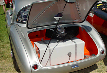

Attached is a pic of the lamp mounted to the body.
