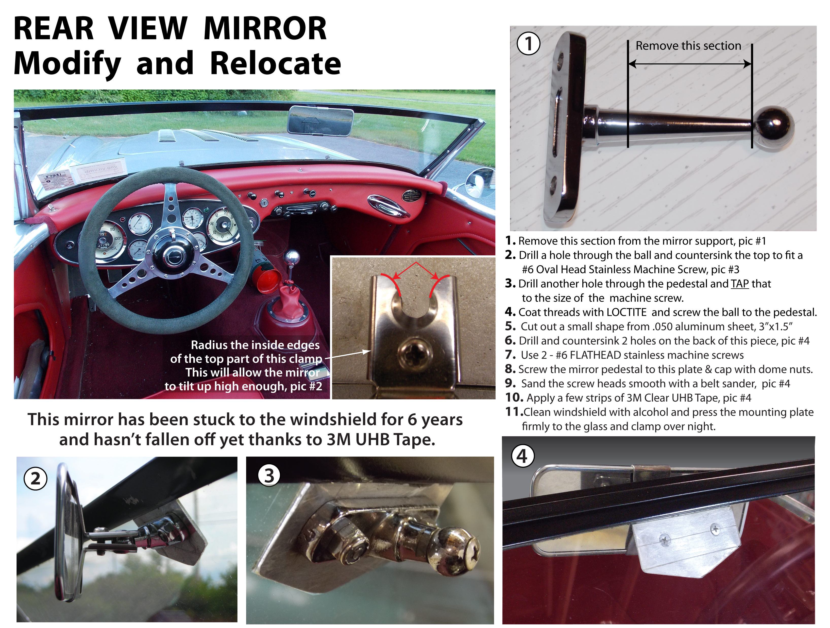

The Rear View Mirror always seemed to be in the wrong location on the dash because
it blocked my view of the right front corner of the car.
After careful consideration I came up with solution.
Now it allows great visibility to the right front corner and a terrific unobscured view to the rear.

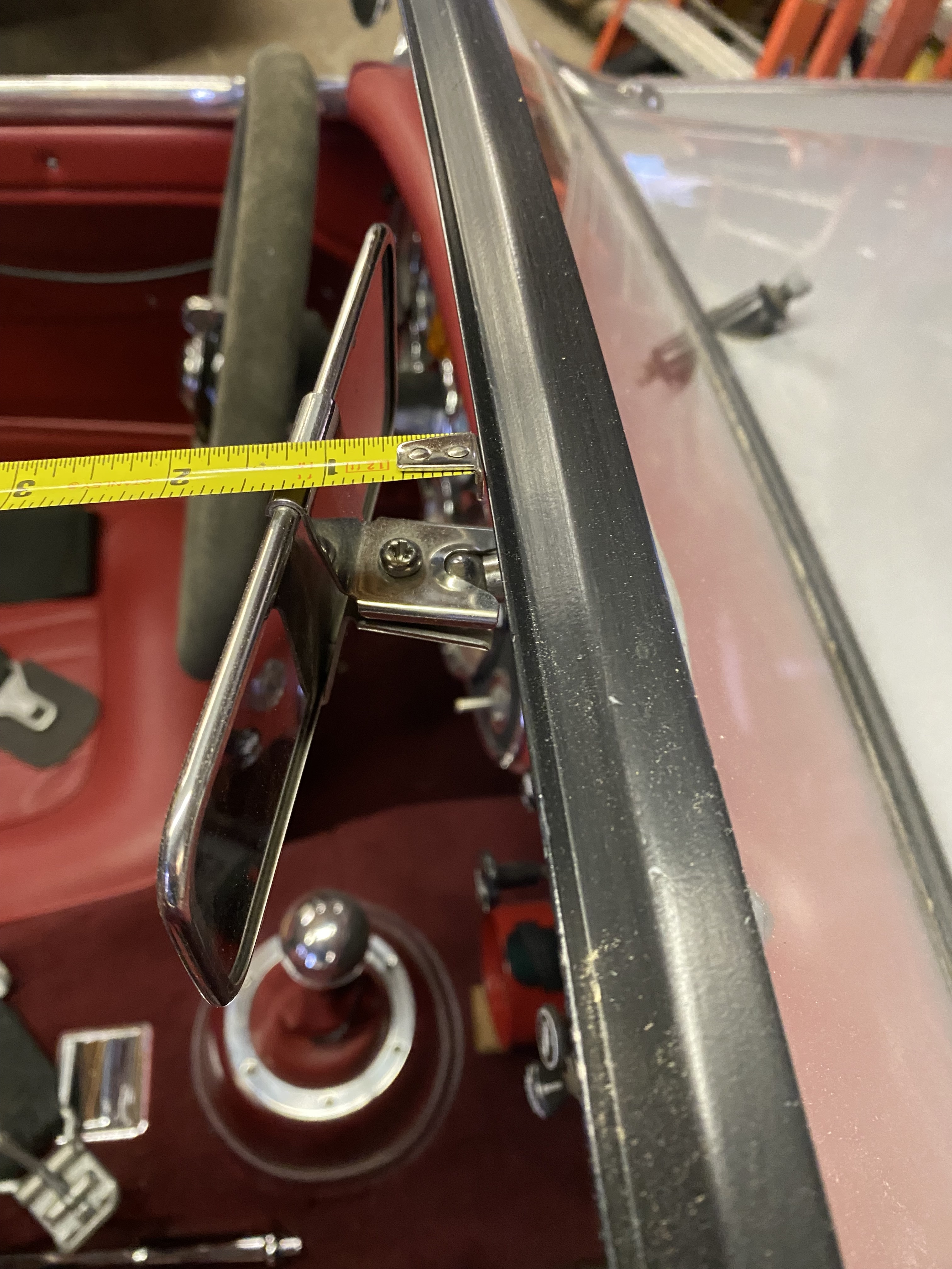

The bigger issue might be how well the convertible top will fit.
In that case you might want to lower the mount from the top edge.
I never put the top up anymore because I chopped the windshield 4" and it now doesn't fit.
