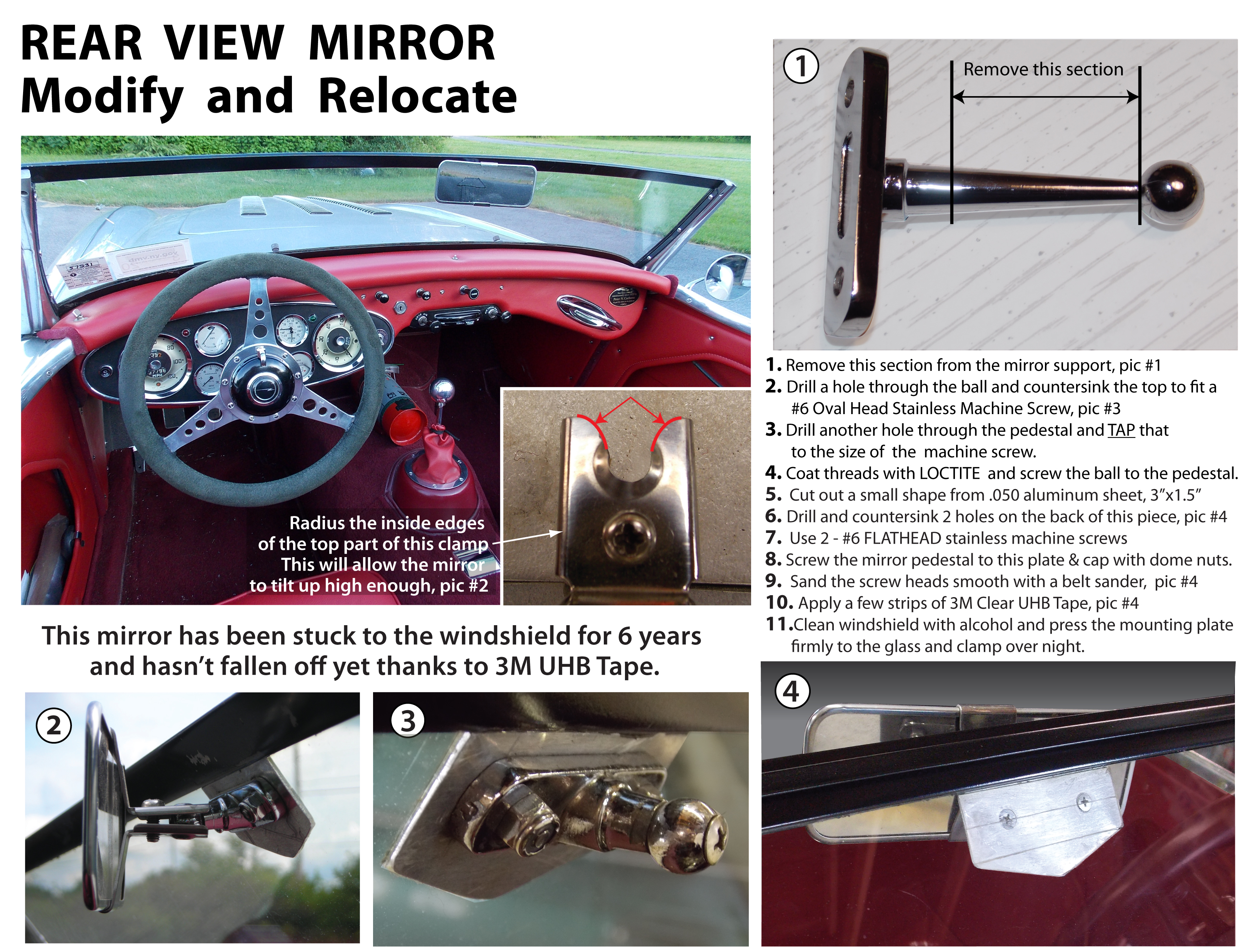

Hi Guys,
I was never happy with the location of the mirror.
It blocked my view of the right front corner and to the rear because I lowered my seat back angle.
This solution has turned out perfectly. Wish I had used Acorn Nuts on those screws.
I never use the top so clearance with the top of the windshield wasn't an issue.
