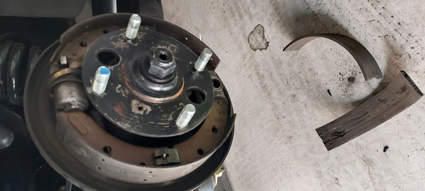

You guys are awesome. Does the attached picture look like a lining failure? I think so! The left side is OK, but I'll probably replace both.

There was no visible evidence of rivets. I see some scratch marks on the back of the brake pads, so maybe they came apart and all fell out. The brake drums are clean with no scars. Something was definitely wrong with those brake shoes.

Probably replace both???You have just received an engraved invitation from the Gods of Good Luck!
You should also do everything else, like wheel cylinders /resurface the drums /check the U joints.
Just saying, when your Tr cries out for service, do it right.

I saw those holes, too, and wondered why the linings don't seem to show rivet holes. In any case, I haven't seen riveted linings in decades. If riveted, they must be really old.

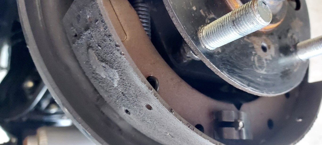

Yep, no rivets, just bonded, or at least they had been bonded once upon a time. The attached picture shows what is left of the bonding. I spoke to Moss Motors and they confirmed bonding, so I have a new set coming. Everything else looks good, although I'll tweak the parking brake a touch.

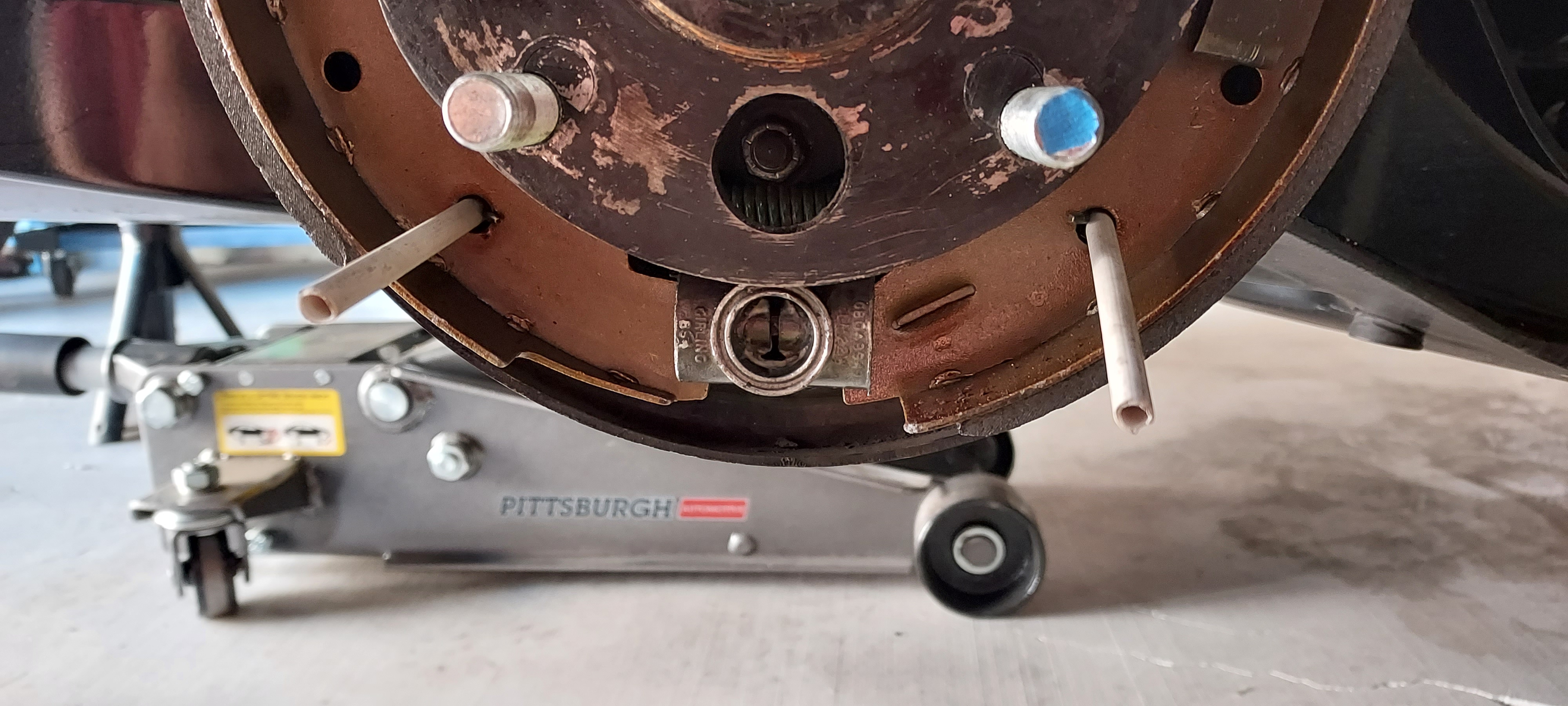

I got a new set of brakes from Moss, made in China and bonded without rivets, and they are installed. I struggled with the lower springs until I found a solution to keep them in place while wrestling with the shoes to get them in place. Note the pegs I put in the holes to keep the springs from popping off everytime I moved the shoes. I used a heavy walled plastic tube I had laying around that fit snugly. Once the manhandling and cussing was done, I just pulled them out and started the other side. It made it much easier.
