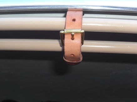

With the top removed and the frame collapsed and stored backward in the tubular brackets, it could rattle. AH supplied the BE with a small leather belt strap that wraps and tightens around the frame center when the top is removed to keep the frame from moving around.

Yes, the rubber bumper is at the bottom, with the bracket mounted on the rear bulkhead. One still needs the leather strap at the top to secure it to the inside of the leading edge of the boot.
Here is what Whitephrog referenced to: the strap.
