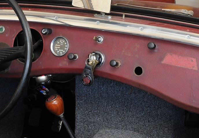

Yep, from all appearances it's original. I'm thinking I'll just tie in to the positive and ground behind the lighter.
I went through the Terry Horler book and there is no mention of a cigarette lighter in the Bugeye. There is mention of a cigarette lighter and ash tray in later Spridgets.
If the original windshield washer pump is gone, a cigarette lighter fits perfectly in that hole.
Empty hole below starter and to the right of the heater switch.

All I am saying is that it is not original. You could drill a hole anywhere and install anything you want in the hole.
Although lighters were not a factory authorized item it is my understanding they were provided by dealers. Lot of smokers in them days. My 60 Bugeye in 1962 had one and the push handle even matched the other stuff on the dash but no words on it.
