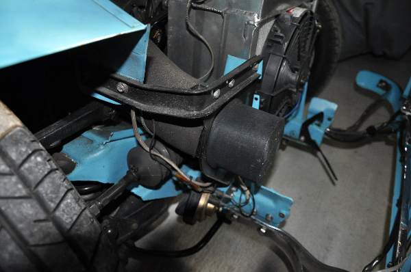

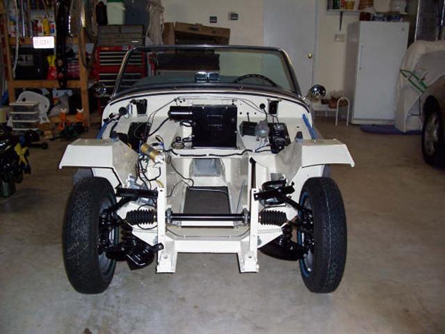

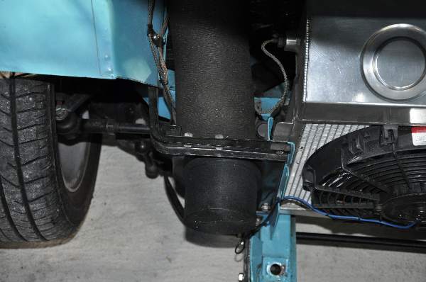

Note the frame coming out the front of the car, each has a built up hole in the top close to the end, a tapered pin drops into this hole from the bonnet.

HTH
