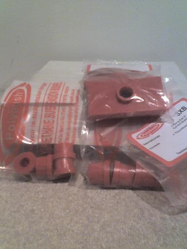

tosoutherncars
You'll never guess which way I'm going...
Full kit (front & rear) $129USD shipped. That's;
1 set upper trunnion outer
2 set lower wishbone inner
2 set leaf spring rear eye/shackle
1 set leaf spring pad
1 set fron roll bar, 9/16"
26 pieces total. Ordered through a Rover dealer in the US that carries Polybush. Looking forward to fitting them, I will report back with results.
