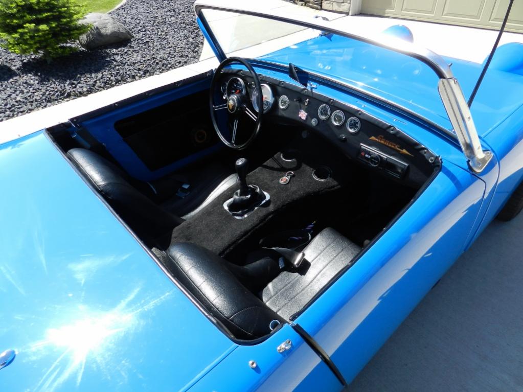

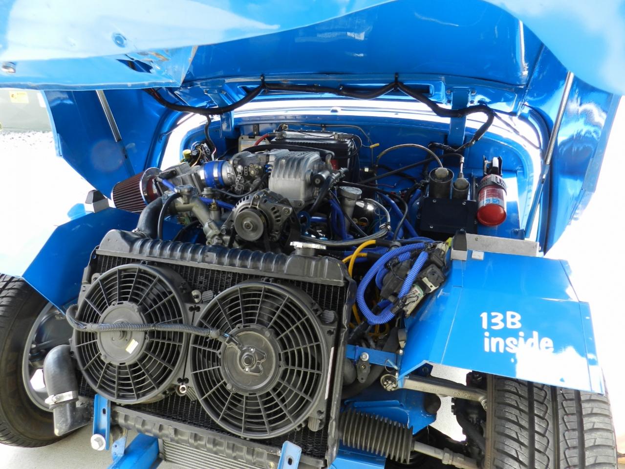

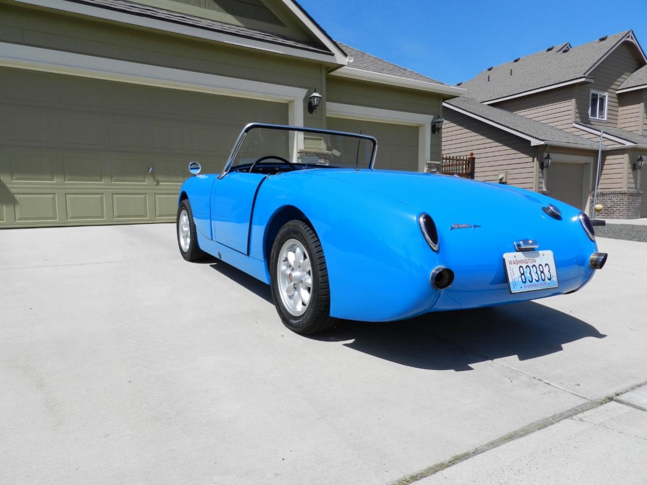

What do you guys think? This fellow wants to sell this unfinished project for $9500. According to him, rotisserie paint, 13B injected rotary, almost completed restoration. Needs fuel gauge wired up, no wipers, speedo doesn't work, no turn signals (the exhaust runs out the holes for the signals now). Things I see is running the exhaust properly and putting signals back where they belong, proper tail lights, may not have a fuel return line for the injection back to the fuel tank (or does it need it??) and most noteworthy is the larger than necessary trans tunnel. Oh ya, he also removed the oil injection for the apex seals and runs 2 stroke mix in the tank to take care of that lubrication (a common "upgrade" so you aren't burning crankcase oil) Let me know

You'll never be able to duplicate it for anywhere near the asking price. However, with a modified car, the true test of its value is how it runs and drives. Does everything work together? Will it drive on a hot day without overheating? Do all systems function properly. It looks really well done. Rerouting the exhaust may take a bit of work depending on the system. Did he mount the mufflers in the boot and seal it off? I don't know about the oil system mod, I'd probably ask for opinions on a rotary site. Adding oil to the fuel is kind of a pain, but not much more than Saab 2 stroke drivers used to do. I was under the impression that EFI motors do require a return fuel line to the tank. Is this car running and driving now? If so and everything checks out, it looks like a "screaming" deal to me.

I saw the video on this one and it is stupidly fast and is set up for Auto-x. Might be extreme for street use and I certainly would want to driver it . There is a guy with 2 B'a for sale on eBay who wants this one and is local to Seattle his 2 BE's one finished and one primered shell are going for the same price.

The exhaust and the gaps bother me. Leave the car and take the chick. :encouragement:

The exhaust is easily fixed, the muffler is under the car. Just a bit of welding to fix that. I did get in touch and it does have a return line for the fuel.
Super fast is what I want, just wanted to see if there were any negatives to what has been done. The car is even the same color I wanted to paint mine :smile: Only thing I don't want to do is the 12 hour drive each way to get it...ugh. There's some beer in it for whoever wants to get it for me!

Rick X2! The work done has to cost 21/2 times the money he wants for it if not more. If you want a rotary Bugeye, this is the car for you!

Im (still) building a '65 sprite with a 12a rotary and ive got well over $9,500 invested in the car so I agree that you cant build it for what he's asking. From the pictures it looks like a pretty good build. Im not sure why the transmission tunnel was enlarged to the extent that it was, the mazda transmissions arent that much larger than the original unit that came in the car. Another option in lieu of premixing the 2 stroke oil with the gas is to run whats called a sohn adapter which uses the mazda oil metering pump to draw oil from a separate reservoir containing the 2 stroke oil instead of using motor oil from the pan or having to break out a funnel and a measuring cup everytime you fill up

The trans tunnel is one thing that kinda bothers me, but I guess it shouldn't. He did go bigger than needed, and very boxy. If it drove me nuts, I guess one could cut it out and fab up something less bulky.
Branson, Thanks for the oil injection link, that seems like the way to go! I was wondering if one would keep a box of 2 stroke mix in the boot for a long road trip.

From what I understand, taking the tail end off the rx7 trans and swapping it with a B2000 will put the shifter about 2" off from stock. Good enough to weld back in the stock tunnel, if one could find a donor car. And that is they way I'd like to do it.

Would you like it to stay a project car or do you want to drive it? Why reinvent the wheel, it's done, leave it be.

Great point, Billy. Drive it for awhile and see if it's comfortable. No one is going to mistake this for a stock Bugeye and going to the effort of putting in a smaller tunnel is just going to take away from your time behind the wheel. Besides, this one's got CUPHOLDERS! Do you know how hard it is to hold a Big Gulp between your legs while your rotary motor is spinning up to 9 grand?

True, if it works and is comfortable then let it be until I get really bored one winter :smile: I admit, the cup holders are kinda cool!
