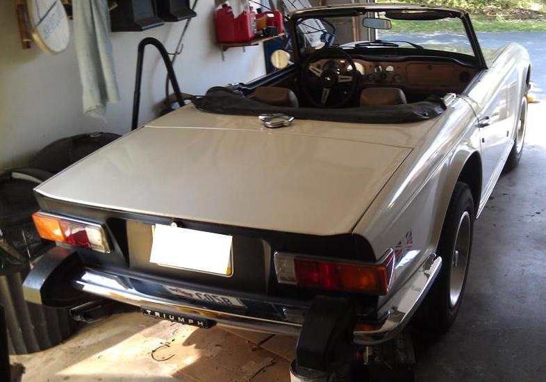

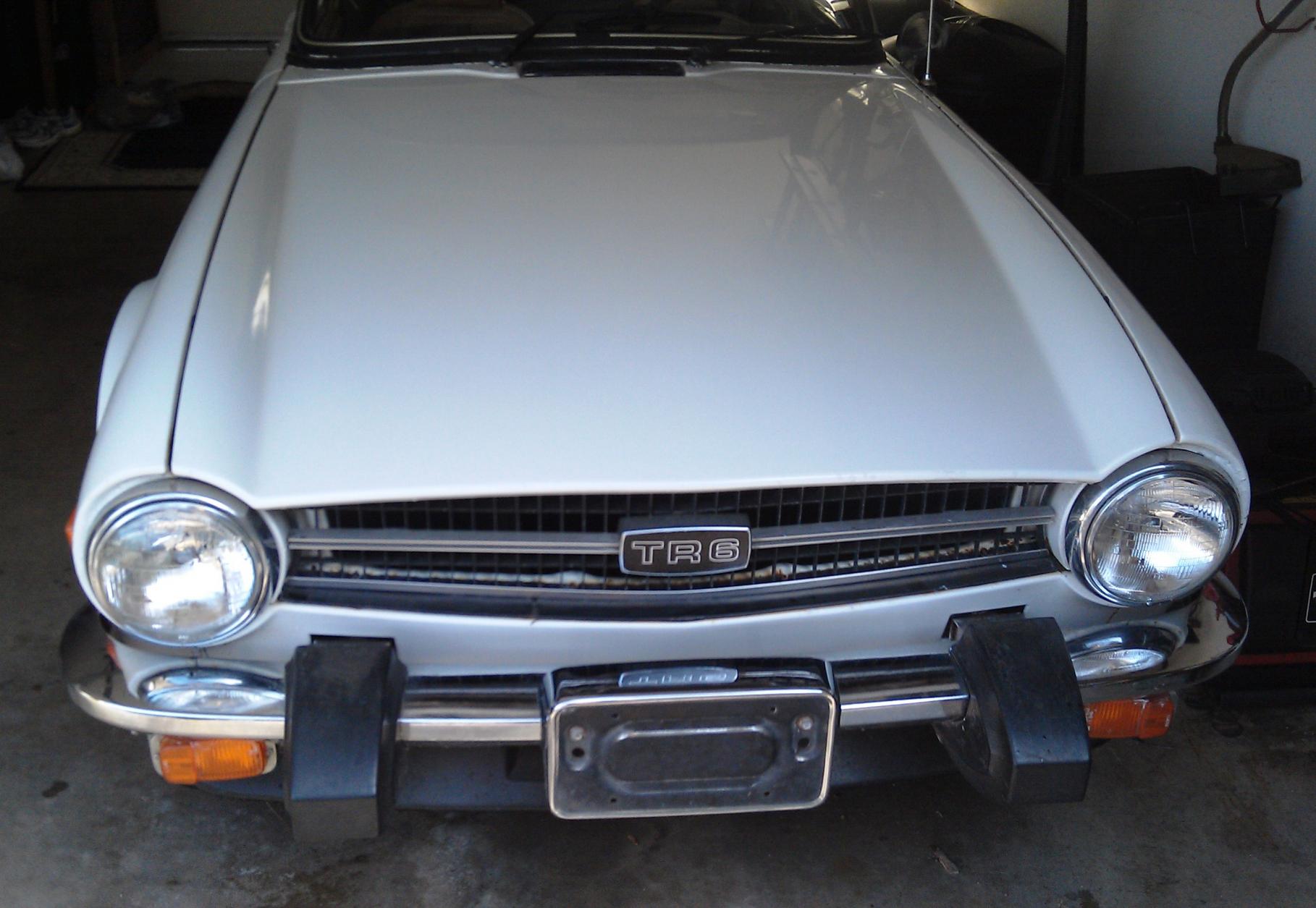

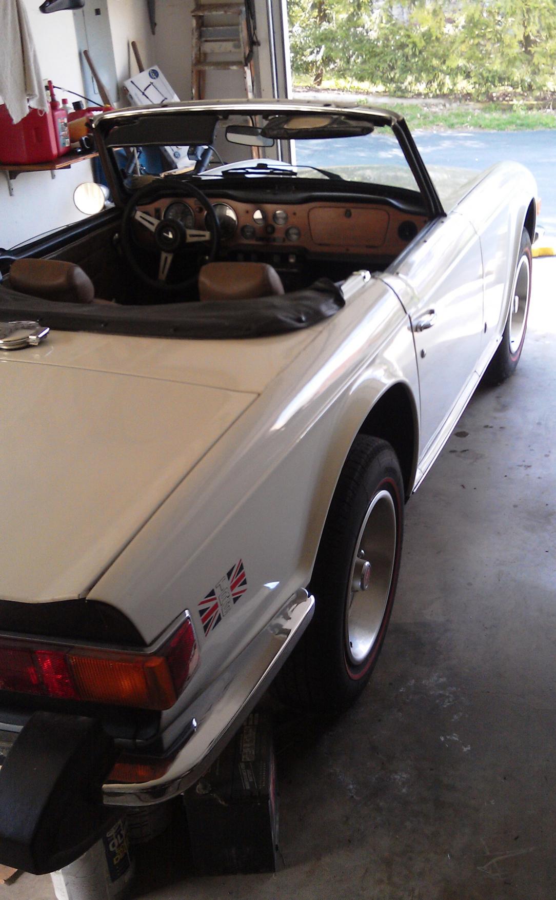

Here are some pics:

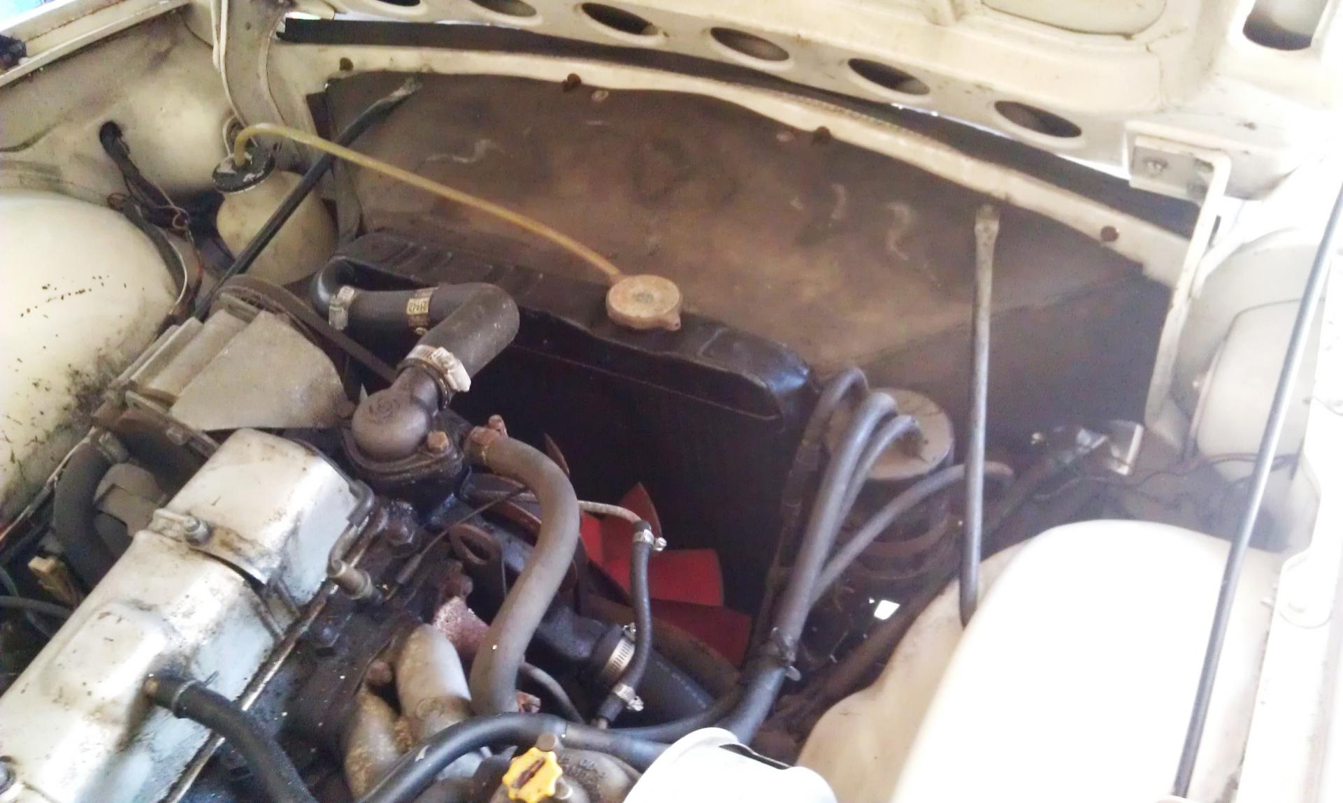

I think what I would do is mentally start out figuring 11,000, then begin to deduct for things that need fixing once you are able to get it running and shifting... things like tires, complete hydraulics, tune up, body work, rust repair, anything else you discover. Be good to yourself and don't discount much because of the fact that you are capable of fixing a lot yourself.
A non running car is always discounted heavy. Does look good in the pictures. With what Poolboy mentioned, your looking around $5k.

Sorry, didn't look at the pictures before I shot my mouth off ! It looks like its in pretty good shape if the paint is original. I like seeing that the color hasn't been changed but white is not a good color for resale . I didn't see if it had Overdrive. That option alone seems to make these cars worth 4-5000 more than a std. gearbox . 78,000 miles is a lot of them judging by the general condition under the hood . I'll bet it needs $10 grand worth of work done to it / half that if you do it. The frame could still be rusted through at the rear mounts for the suspension even though it looks good on the outside. If it was running , driving and stopping well , then what would it be worth ? $8,000 without od , $12,000 with. You have to buy this one cheeper than we think.

I'm playing the Devil's advocate . It looks like a decent car that has just been neglected . Under the hood it looks to have had NO care. What does that mean ? At 38 yrs. old and with 78,000 mi. on it , its uniformly worn out, isn't it? All the rubber seals , bushings, hoses, pads etc. will all have disintegrated. Even if the engine starts and runs ok, it will probably want an overhaul , same with the clutch - they only last so long. The same goes for : steering, suspension, brakes. Probably nothing major has kept it off the road , just a lot of minor things to all the major systems. Before you know it , you've rebuilt the whole car.

FWIW it looks as though it may have been repainted at some point given the white paint showing through the grill so you may want to assess when and why. Cosmetically the exterior and interior look very nice.
Gliderman8
Gliderman8
Dave, I did address the repaint with the seller. He told me it was resprayed the original color some years ago to freshen it up. There is no body damage anywhere that I can tell.

Looks good to me.
I'd be sure to check the frame mounts for the trailing arm in the rear suspension.
It kinda reminds me of my white '69 MGB which was also ignored but in decent shape. It had similar miles and was always stored inside too (I bought it for a lot less than $5K, but it was a weird circumstance).
By-the-by, white is my favourite colour on cars. We have four white cars (three bought new).
$5K is probably a fair price if the engine isn't stuck and the rust is only superficial.
