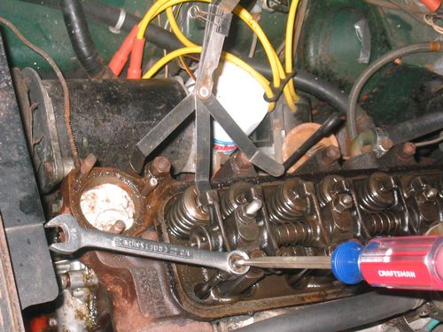

OK let me get this straight. As I turn the engine by hand the rockers go up & down. When Valve #1 - front of car, is open, the rocker should be compressing the spring, in turn. Now adjust valve #8 for proper clearance .015".
Does that sound right.
vping
vping
Bronze
Hurray! First time adjusting valves. Felt good and got into a good rhythm. Only 20 minutes but slow & steady. I think I got it down now.
