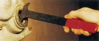

You need one of these pullers ....

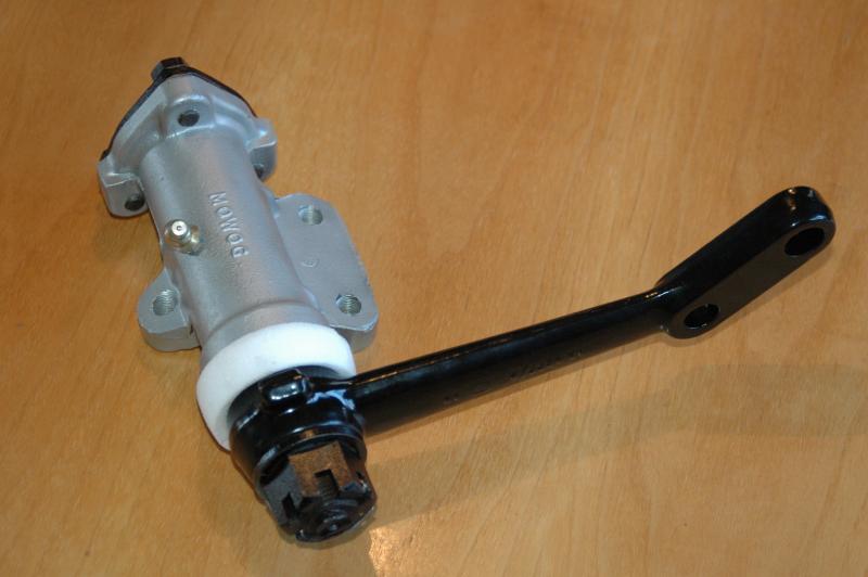

The idler is opposite the steering box ...
attachment.php
Big Green, did you install the zerk fitting in the body of the idler? Mine doesn't have one, just the square headed plug in the cap to refill the oil. Do you use chassis grease instead of oil?
