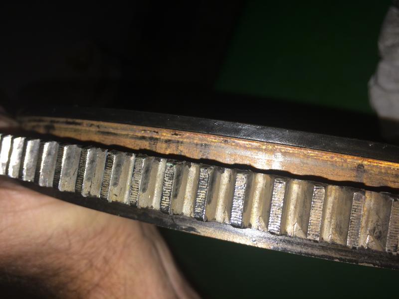

Another possibility on the starter is that the ring gear has moved back until the starter can't reach it. Be sure to take a look when you pull the starter out. Someone posted a photo recently, but I don't have a link handy.

Here you go. It's certainly worth a look to see if the ring gear moved.
