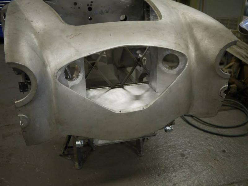

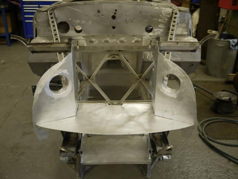

Has anyone built and installed panels behind the grill to funnel air through the radiator? I can't find any source for the early Healeys.
These two pics were saved from the JME Healeys Facebook page. Album = "BN2 Racecar"
Thank you, that's the kind of stuff I was looking for. I was thinking I could only get an air hose on passenger side, was thinking steering box would get in the way on driver's side.

Have to say I took more of a piecemeal approach to air control. Panels as shown in the above 100-4 photos might be easier than a lot of small panels as I have done.
Randy posted some pix in an earlier thread of his panels which might be appropriate.

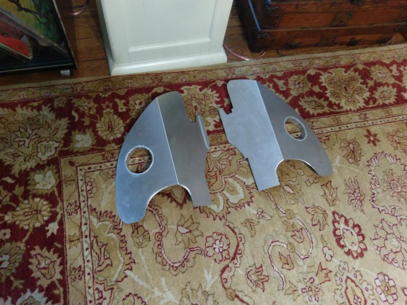

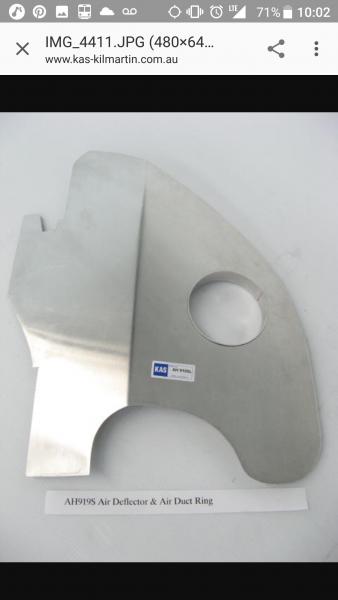

These came in today. Very nice pieces from Kilmartin shipped all the way from Australia.IMAG4096.jpg
Tried installing today. Should have just started from scratch with aluminum panels and some cardboard and fabricated my own. Was thinking these would work on my BN1 or at least save me a lot of aggravation. They were not a good fit for a BN1. Ended up cutting them signficantly. Lesson learned.
