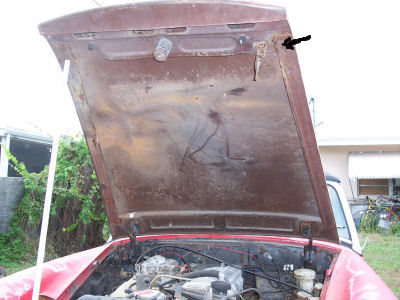

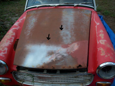

I have a very good used hood (bonnet?) if you are interested, PM me!
bugimike
I thought I had a really good bonnet. Had not looked at it in a while! Just went out and looked it over and found some rust-through that wasn't apparent before, but the Fla. humidity got to it! Nothing real major, but PM me and we can talk! Arrows on top indicate 2 small dings. Arrow on underside shows only spot underneath with some surface rust and as you can see rust-through on drivers leading outer edge. It is solid underneath these spots! Other than these blemishes the hood is straight and solid!

looks similar to what i have already mike.......

From looking at the pictures, you may want to get the whole nose cone replaced. I think it may be more bent up than you realize. But... I may be wrong. It might be prudent to disassemble things and take a look before buying anything.
bugimike
Looks to me like what you have already is pretty bent up!
