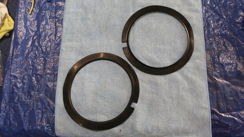

i got these headlight gaskets from TRF, but they look nothing like the ones on there now.
I'm wondering how they are fitted?
Thanks!

Yeah, if you were looking for the gasket that is between the bucket and the body - that ain't it.

I couldn't figure out how to make those gaskets fit either, so I just left them out. Might actually be a Good Thing, leaving them out should allow more air to circulate around the back of the bucket.

i left those gaskets off too. I never drive in the rain or even if it's wet out, anyway.
