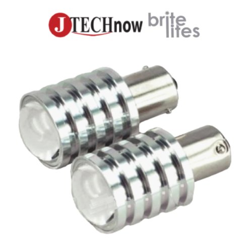

You would need resistors if you change the lower lights to LEDs. I'm not familiar with wire numbers for 100s, but I converted my reflectors to brake/turn signals using these LEDs:

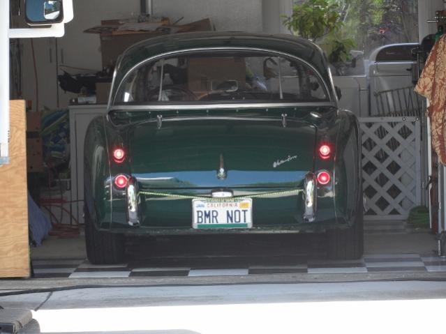

With these LEDs, the brake lights look like this:
