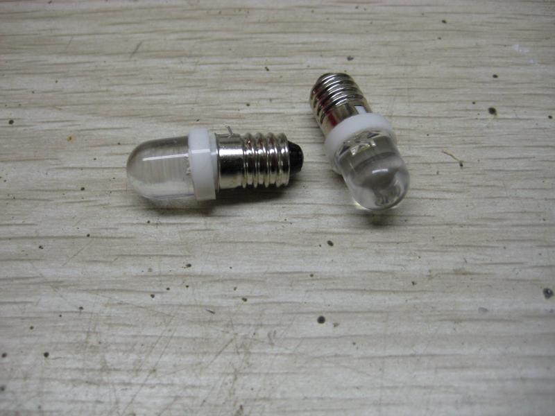

I ordered some LED dash lights to replace the original bulbs in my BT7. See photo below Unfortunately they were not very useful. The light projects directly out the end and has very little light out the sides where it needs to be to light the gauges. Also, they weren't very bright. I tired them in a flashlight also with no success. The only good news is the four bulbs cost less than $2 including shipping from China. Maybe that was the problem......
Anyone have good results using this style of bulb to light there gauges?
I think Roger did, search for led's with AUSMHLY as the poster. You could also try to scuff one of the "bulbs" with a fine grit sand paper, like 400 (dome and sides). That might disperse the beam to the sides more, but there is still the issue of them not being very bright.

The depth on the bulb is critical. The ones I ordered fit the large gauges, speedo and tach, but were too long to fit in the smaller gauges, fuel and combo. They hit the back of the dash before the holder is seated in the gauge strap.

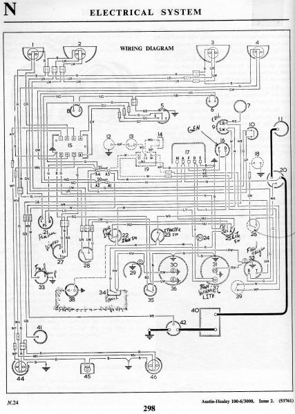

Mert
https://www.superbrightleds.com/. Go to this website. I used their products to install LEDs on my BN7 dashboard lights to include the front and rear parking lights. They have tech support that is very knowledgeable of what you will need. Also, you will need to replace the flasher. And might have to install a resistor on each the front wiring and rear wiring at the relay box (LF side).
vette
Thanks Mert, But I don't have a relay box. If you look in the pic under my handle name my BJ7 has lighting arrangement like a later BJ8. I'll look for a better pic. Anyway as such my turn signal lights work quite well with LED bulbs. I am only replacing the dash bulbs at this time but I do have one LED bulb in my right rear turn signal lamp. The reason I did that is that I have original glass beehive type of lenses. the one on the right rear was always very much darker glass than the one on the left rear and it wasn't nearly as visible as I wanted it. I was going to buy a new lens but one day popped in an LED bulb just to see how it would look and Vola, it matched the other side perfectly so i left it that way.

Mert
My BN7 was an early make with a 100-6 front wiring harness. It also had the center trafficator lamp. Per your schematic you have a relay box. It is item 15. There is where I put the resistors. My BN7 was positive ground which required the resistors. As for the flasher, with LED's - you will need to replace the original. Otherwise the LED's with flash with a rapid pulse. Your schematic is the same that I used with my BN7.

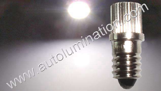

AUSMHLY
Hi guys, happy new year.
I don't visit here as often as I used to. Just so happens today I did and I'll chim in on what I did years ago. Here's the link, spoiler alert, lots of reading.
https://www.britishcarforum.com/bcf...e-with-LED%92s&highlight=brighten+dash+lights
Here's the need to know about led as gauge bulbs.
Stock bulbs are incandescent 2.2 watt E10, screw type.
If you replace with an led, make sure your car is negative ground. If you're staying positive ground, isolate the housing or buy led's that will work with positive ground. Moss now sells both, neg/pos led gauge bulbs.
As mentioned, most led's are forward beam focused. There are many that have a chip on the top that spread the light out more like an incandescent. My write up addresses that.
Pros/cons.
Led's are brighter but color is usually blue/white.
Once you find the right E10 led that disperses the light like the incandescent, it still will not light up the gauge fully. It will still be brighter where the bulb is and the other side will still be a little dark.
Here's a link to the ones I used E10 Superstar Led Bulbs
https://www.autolumination.com/otherleds.htm
How to illuminate the full face of the gauge? Drill a hole in the back of the gauge accross from the factory one and add another bulb holder.
Now I had 2 E10 led 1watt full dispersing bulbs. Just too blue/white for me. Looked too modern.
What I ended up with was, two 2.2 watt incandescent bulbs in the large gauges. Filled them in nicely and has the correct shade of light.
For the two smaller gauges I replaced the 2.2 watt bulb with an incandescent 4 watt oblong bulb. (no room to ad another bulb in the small gauges)
Eventhough Moss recommends not using an LED bulb... "LEDs should not be used for turn signal indicators, or for the red generator/alternator light on the dash"... I did.
I can now see the signal indicator during daylight. Could not before. I've had no problems replacing those. I'm negative ground.
vette
Hi Mert, I believe you missed my point that I used that schematic for a lot of the rewiring but MY CAR IS DIFFERENT IN A NUMBER OF WAYS. One of which is that " I do not have a stop/turn relay box". I used that schmatic to show that I have only one indicator on the dash which is item # 24. I do not need the resistors or the alternate flasher because I already have LED in the rear turnsignals and they work just fine.
