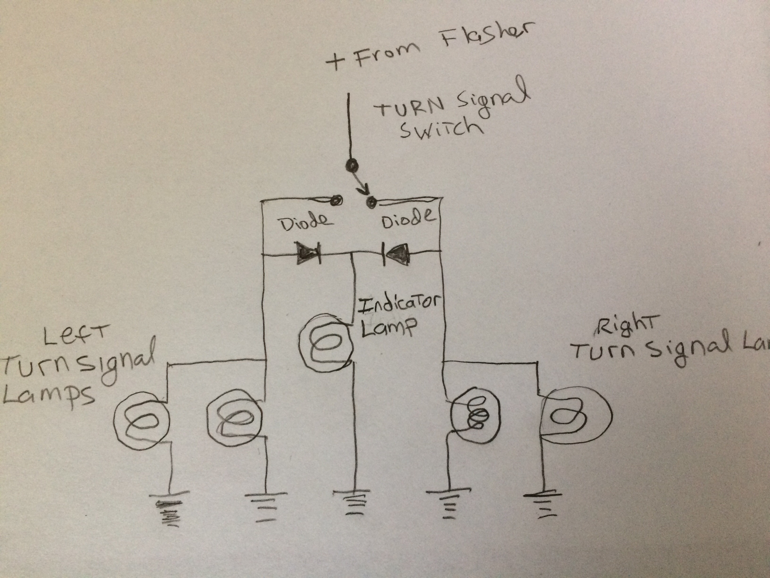

This is how I solved the turn signal LED problem... it works great and just a few pennies for the diodes.
