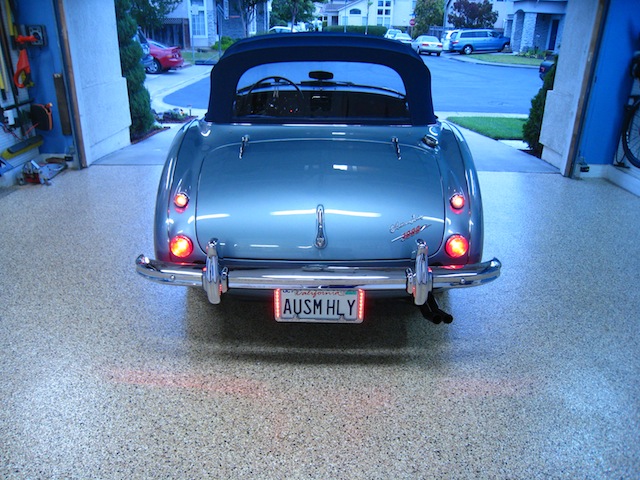

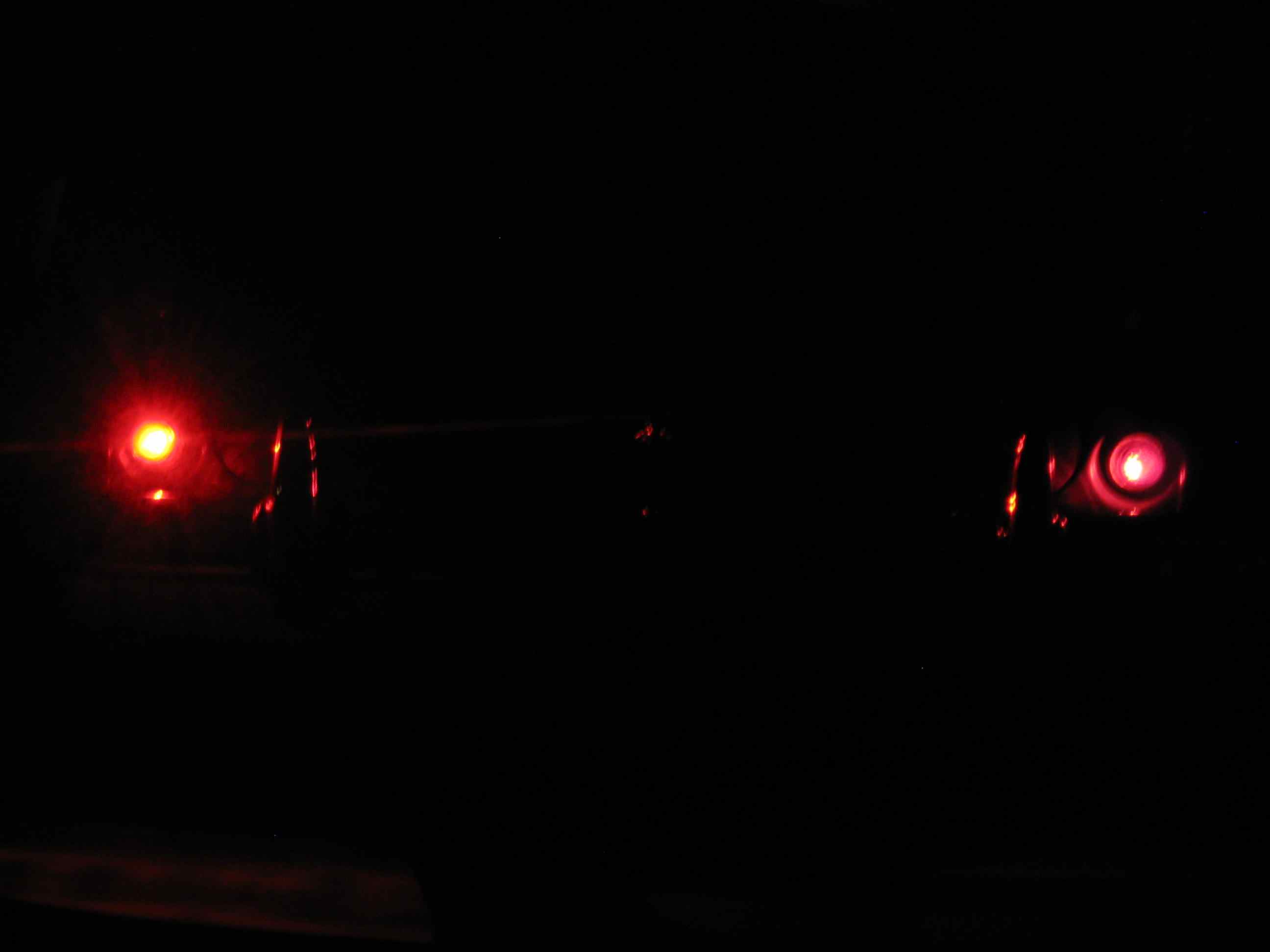

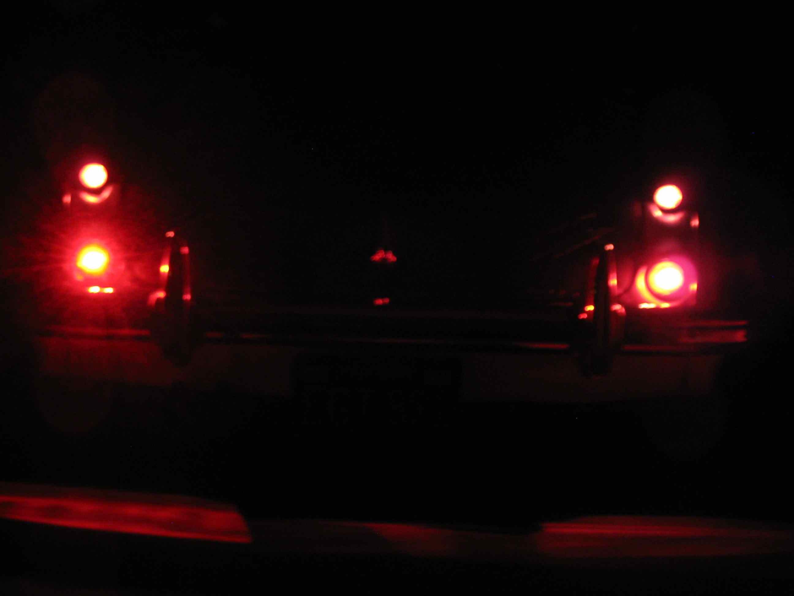

I installed the LED lamp discussed in this thread on the left side of my BT7. The new LED lamps are definitely brighter. Not sure the photos capture the difference but it is very apparent.
The shot with the reflector lights lit up show the lamps under braking. The other shot shows the lamps with just the parking lights on.
I kept the old style 1157 lamps in front. Also, I did not change the flasher switch to the electronic version and the turn signals work, although the LED side flashes at a rate about twice as fast as the old style lamp side. Not sure what will happen when I replace the second old style rear lamp with the LED.

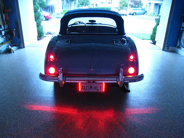

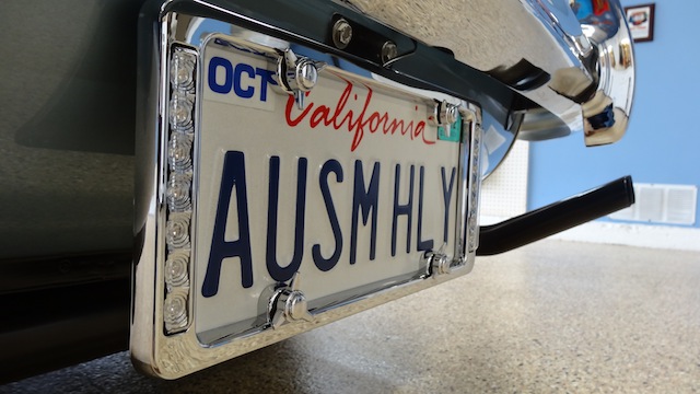

AUSMHLY
I'm trying out an led license plate frame. Lights up red only when the breaks are applied.
