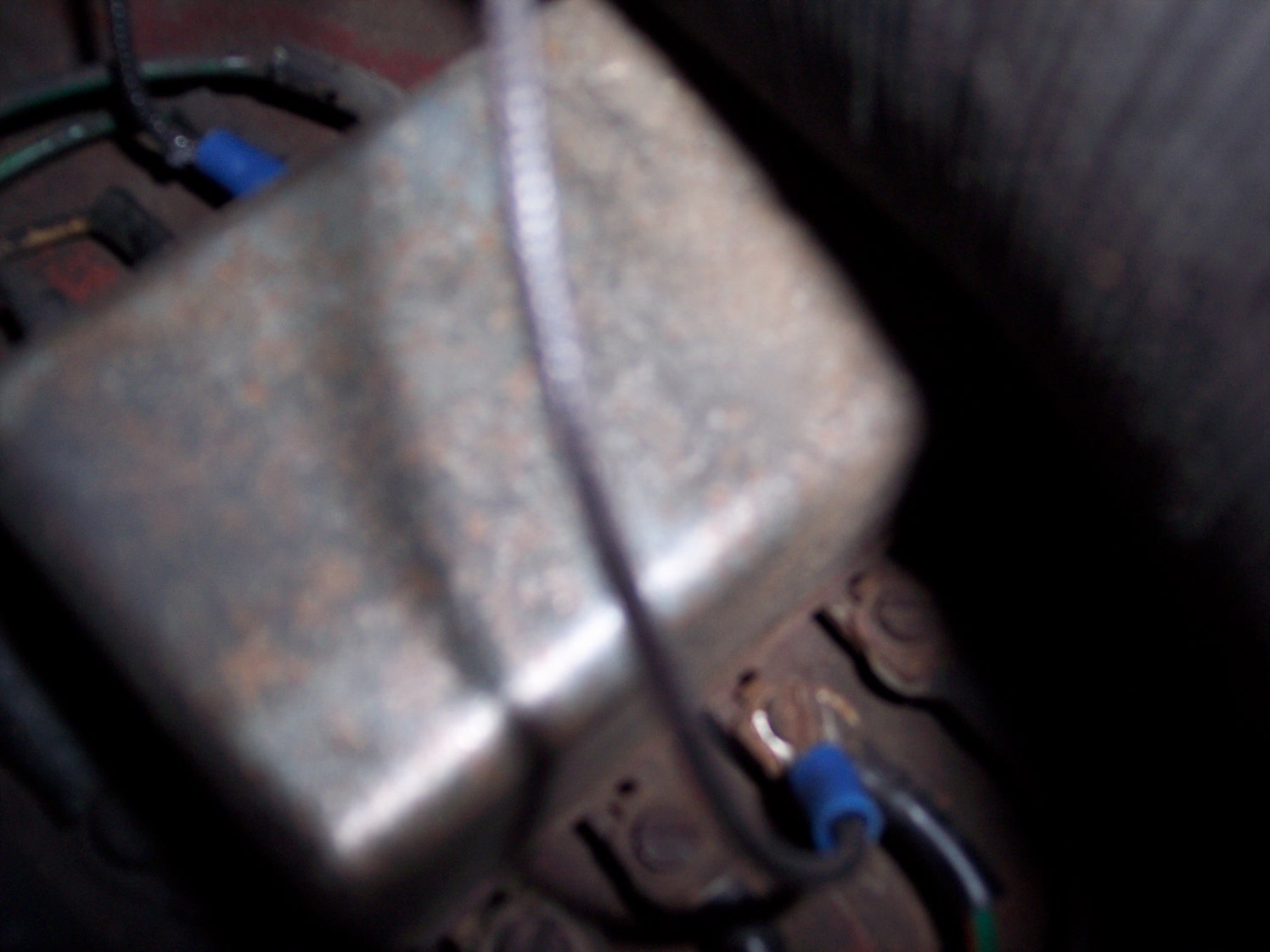

I converted all my instrument and parking/brake lights to LEDs last year on my 60 BN7. You only need 2 resistors. One in attached to the #2 lead and the other to the #6 lead on the 8 lead unit that is attached on the interior LF fender near the radiator. One wire lead from each resistor is grounded. The #2 and #6 lead points are for the left side and right side wiring circuits. (photo). Attaching them here conceals them from around the flasher unit. I mounted each resistor on an interior strut using a twist-tie. 100_2346.jpg Hope this helps. If you have problems with the flasher not working correctly after installing the resistors & LEDs, I have a solution for that, as well. My project took several long days to finally get everything working correctly.

I appreciate how you have applied the resistors to the Flasher Relay terminals to apply sufficient resistance to each signal side. Did you retain the original heat-switched flasher or changed it to an electronic unit? What resistance resistor have you applied?

I originally used Superbright LEDs along with the FL-3 flasher. The initial set up failed. Then bought non-polarized LEDs. That didn't work either. Got the flashers to work, but the instrument panel flasher blub blinked like crazy. Also, sometimes I had no rear light or front light. I worked on this project for over 6 months. Trying different types of flasher units. The FL-3 would not work for me. At the same time I was replacing all instrument panel bulbs with LEDs. In frustration I located a manufacturer in Oregon. Classic Auto LEDs, LLC. Steve was my saving grace. I bought his products; personally talked to him on several occasions. Finally - everything worked to include all the dash LEDs. The correct Load Resistor is a RL-650 6 ohm 50 watt. As for the flasher, Negative ground cars can use an electronic or electromechanical flasher. Positive ground cars MUST used an electromechanical flasher. Electromechanical Flasher : Tridon EL12 (2 pin) or Tridon EL13 (3 pin). Electronic Flasher : CEC Industries EF32 or EF33 OR Bussmann 232 or 233. I bought the Tridon EL13 at Auto Zone. I have 2 sets of Amber and Red non-polar & polar leds; 2 load resistors; and 1 FL-3 flasher now in the parts bin. Hope this helps... Mert
