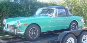

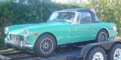

If you can find Cosmos rims, you can put 175/70 R13 tires on a RWA midget.
Got them on mine. No rubbing, great grip.
See attachment.
DesertSprite
GTsRFine,
That's a sweet lookin car. Definitely like the rims. Something different besides the standard Minilites. Weren't those original on Alfa Romeos or something like that?

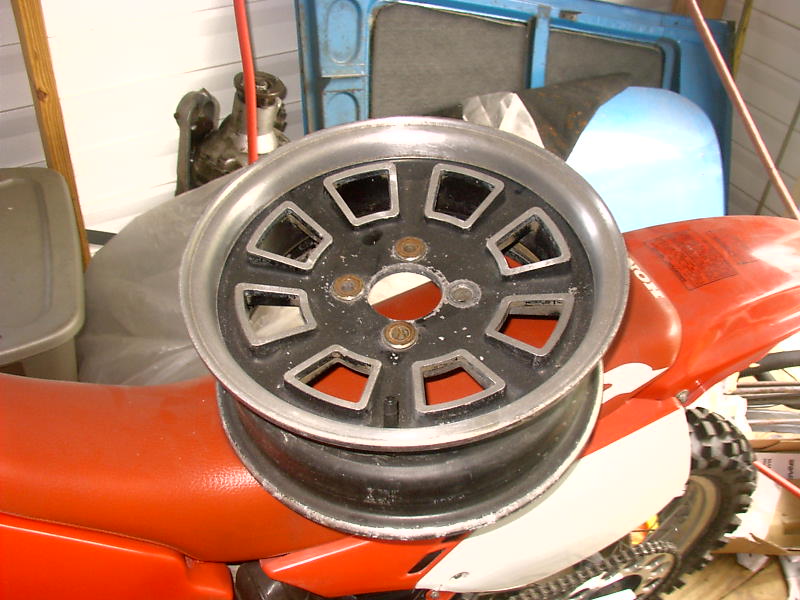

hottvr
Hey Baz,
I have a set of 4 rims that I think match yours that I was going to put on EBAY but never got around to it. Any offers?
See attachment
