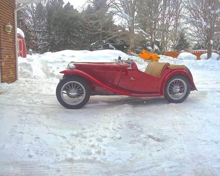

Its always great to hear that another one is on its way to getting back on the road ! What kind of shape is the body in? Is the wood in the tub ok? I was lucky with my TC in that regard, though it isn't perfect. I imagine Hawaii can be hard on one of these, in the midwest most of them weren't driven in the winter. Kevin IMG_1629.jpg
