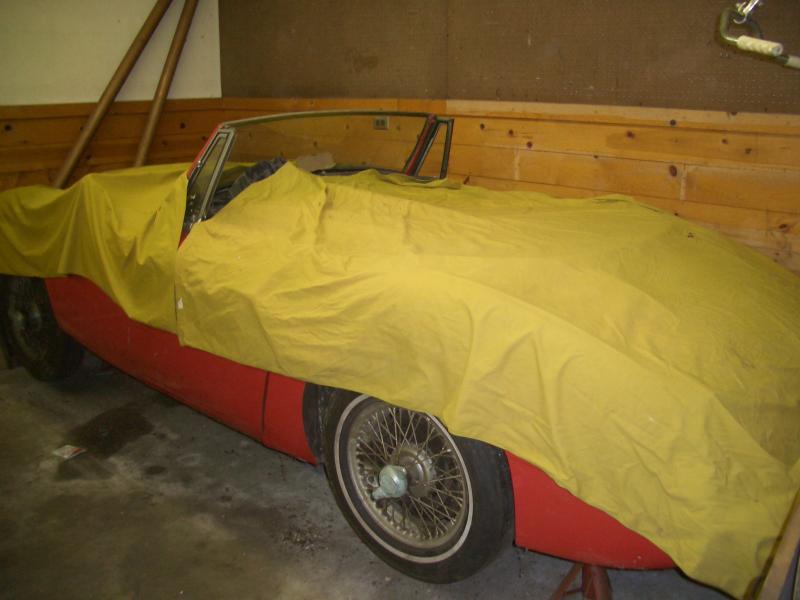

OK, time for an update. I'll give a brief overview of where we started and what has been done up to this point. As I mentioned, the car was in storage for quite some time. It sat in the back of a large residential garage up on jack stands from about 1989-2005.
We got the car running and drove it around the neighborhood a bit (as I mentioned in the first post).
https://www.flickr.com/photos/30988769@N08/20189917990/in/dateposted-public/
https://www.flickr.com/photos/30988769@N08/19757351333/in/dateposted-public/
A couple shots right as we were getting into the tear down. Looks pretty good right..?
