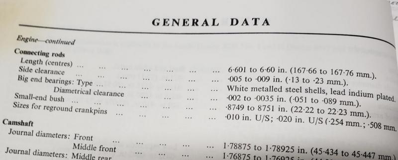

I believe I have a '62 Healey BJ7, block casting number AEC881.
I need the big end specification for the connecting rods, casting number AEC790S
Thanks,
