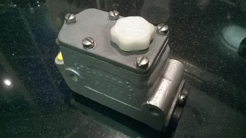

If you want that to improve, you'll want my master cylinder conversion. It will reduce pedal effort by 33%. You could either send your core to be redone or maybe, considering cost of shipping from Canada, you might want to consider buying one outright that I already have built and ready to go.

We have a running (as of yesterday) BE with a 948 and standard drum brakes and the stock master cylinder - it's the one I was remarking on having to get familiar with the braking effort versus stopping distances. The one we're assembling has the upgraded front discs and rear drums, and the master cylinder was one of the last to be rebuilt & sleeved by Sierra Specialties a few years ago, with the bores modified to match the Rivergate clutch system and the Spridget front discs. I expect that I'll be talking to you if/when we upgrade the drum/drum yellow BE to disc/drums. Thanks again - and thanks for your thoughts on the rocker shaft locator screw. Doug

I don't know if you are aware of it, but I was the impetus for this conversion. It was always a collaboration with Sierra, beginning in 2006; what you have is one one and the same.
Dang! Did NOT know that! Congratulatons, and a sincere 'thank-you'! Doug
