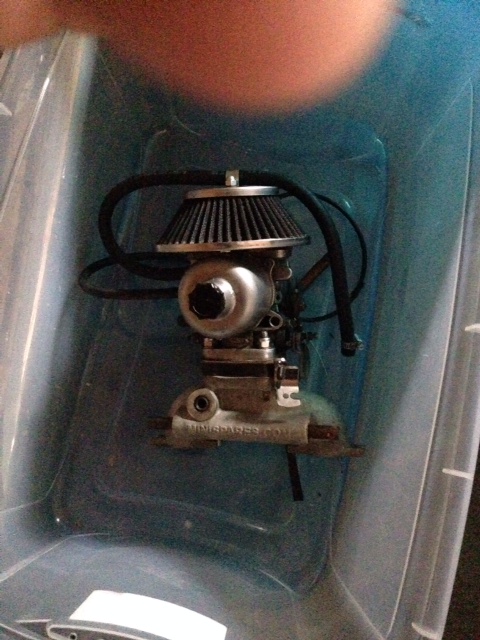

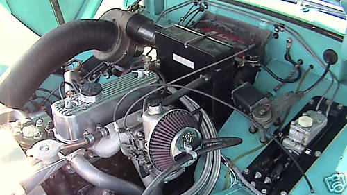

I did indeed run a single HIF6 in the past. Then it was twin HS4s now it is twin HS2s.
I still have the HIF6 and intake. I'll look and see and take a pic or two.
I use an Aldon Yellow dizzy with vacuum advance. I'll take a peek when I get home to see where the carb/intake port is located
on the HIF6.
That HIF6 ran flawlessly on my 1380. No hesitation. I just wanted two carbs under the bonnet.
It's still for sale....but it is a bit pricey. The intake is for a big bore and the carb is setup for big bore as well.
Really a neat bit of kit. Complete with stub stack, K&N cone filter, all linkage and cable included.
Sounds like you may have an intake leak.
The pic is from the past when I used the HIF6.

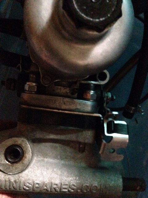

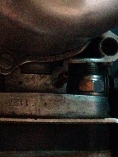

The vacuum port
Sorry for crappy I-phone pics
