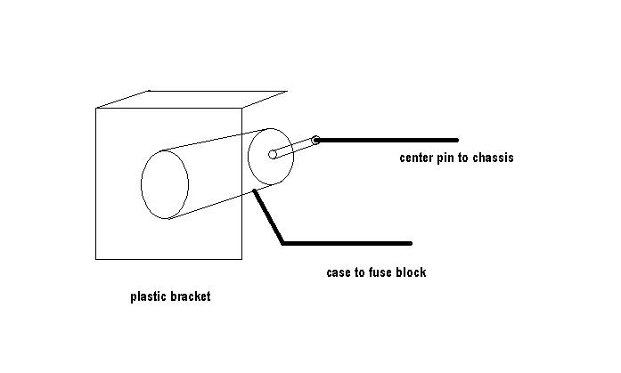

People used to wire -grnd radios into +grnd cars all the time; the radio cases were metal, so they just had to be isolated from the chassis of the car (think wood). Nowadays, with nearly everything being made of (non-conductive) plastic, I'd think it would be pretty easy to do. Just wire a hidden (under the dash) cigarette lighter recepticle reverse ploarity and you'll be set (center of pin to chassis and case__isloated from chassis__to the fuse block).

[ QUOTE ]
[/ QUOTE ]
I like that idea. A cigarette adapter hidden under the dash. The GPS unit gets suction cupped to the windshield. Simply plugs in under the dash. Perfect.
Really that simple?
Isolate the bracket that holds the cig adaptor with rubber or similar fashion so that it does not ground.
The GPS's center pin which is positive, would be connected to center pin of the cigarette lighter, which now becomes a positive ground.
The GPS's outside two pins which are negative, would be making contact with the inside of the cigarette adaptor which is now positive, going to the fuse block. Connected to a fuse?
Is that correct?
I'm not sure I understand. Seems the Negative for the GPS will see positive, being attached to a fuse ?

[ QUOTE ]
[ QUOTE ]
[/ QUOTE ]
Really that simple?
Is that correct?
[/ QUOTE ]
See (crude) sketch...

Thank you for the sketch. Seems simple enough.
Radio shack sells a kit for a cigarette lighter. I has a plastic bracket, just like the one in your attachment. That will isolate the unit.
I would like to put an inline fuse before splicing into the fuse box.
What size fuse is being used at the fuse box?
Where should I attach at the fuse box?
What size fuse should I put inline?
Have you done this to your car, or know of a car this was done to?
Or is this a, this should work exersize?
Thank you Randy.
GregW
Platinum
Hey Roger,
If you want to play with the GPS while the ignition is off, plug your new wire in with the brown wire on your fuse block (always hot). The white wires are switched on with the ignition. Check your GPS owners manual for fuse recommendations, but I think 5 amps would be more than enough.
