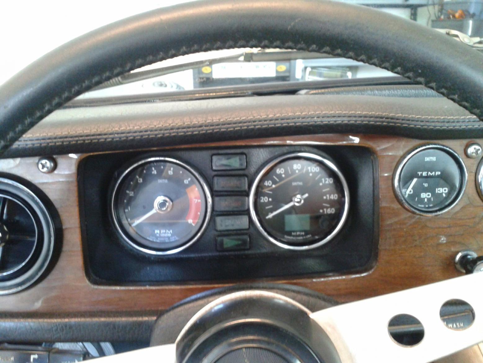

So the speedo on my 74 Europa died. Turns out it was neither the speedo or cable, but the gear drive that goes into the transaxle. That part is no longer made, and when you do find one in someone's parts bin it's very expensive...and likely will fail again.
So I 'built' a GPS speedometer on the Speedhut website. Installed pic attached. Not perfect but not bad...right down to SMITHS on it.
Has speedo, odo, tripometer, and 0-60 timing.

Looks nice.
