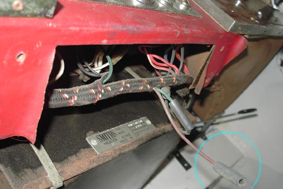

Hi TH,
Probably (maybe, possibly) the most convenient power source would be the brown wire for the radio seen here in the photo. Always hot.

Thanks all. It was very easy with the unit Roger mentioned from Radio Shack ($6.00)And the use of the brown wire GregW suggested. There were two screw at the back of the glove box (BJ8)that were the exact distance for the bracket. It hangs down out of sight in the foot well. Very cool and cheap. Now if the windshield was a little bigger I could put the Tom-Tom on the on the glass. It was free in a contest I entered so I'm really stoked to only pay 6 buck to install. This will be a big help going to San Diego and other Healey rides. How did we ever survive with out this technology.
