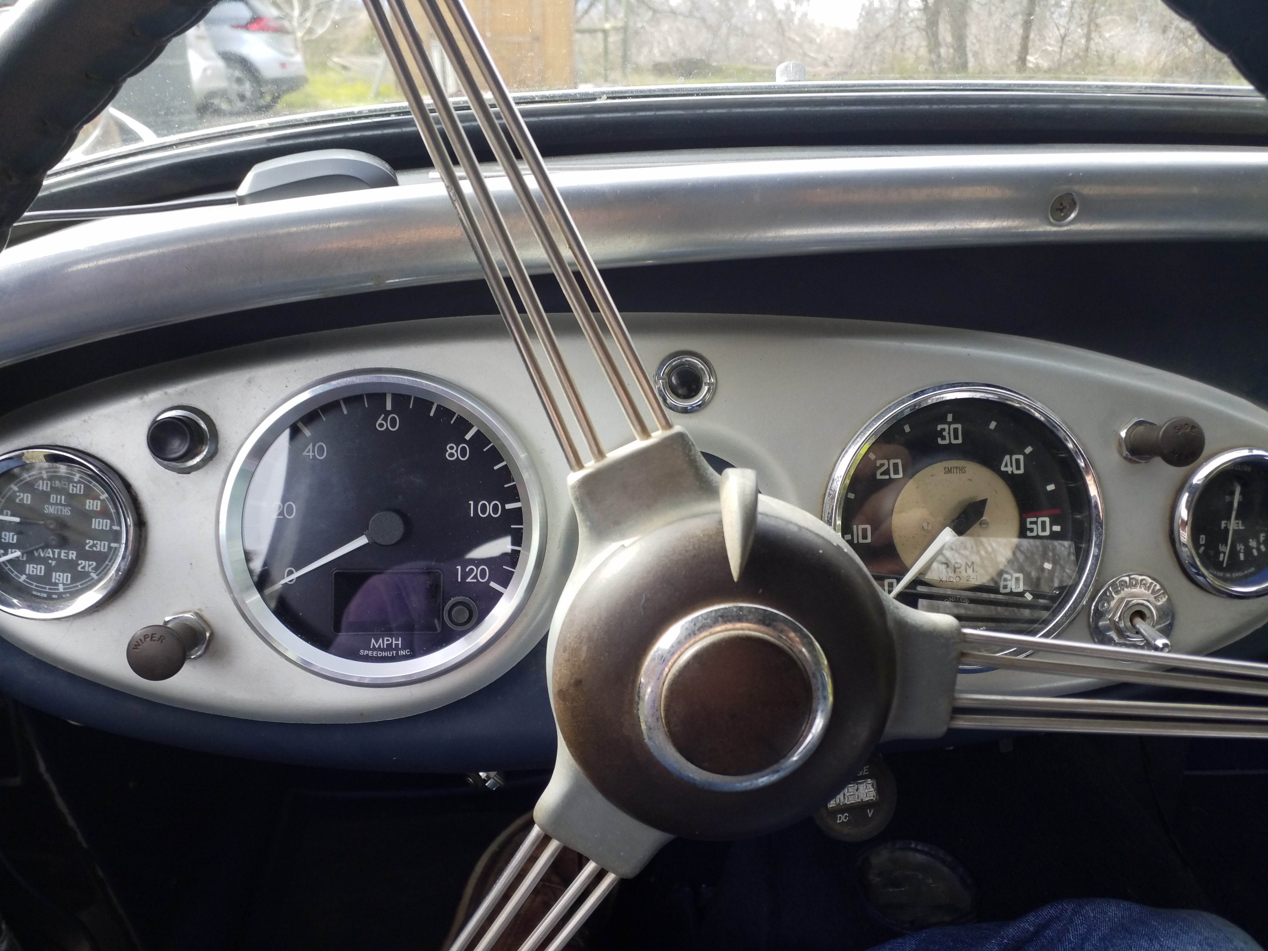

Over the last couple of years I added a Toyota 5-speed gearbox, and a 3.54:I ring and pinion set to my differential. On top of that I run non-standard tires. As a result, my speedometer doesn't register anything near to an accurate speed. I have been meaning to take the simple measurement of counting the number of revolutions my speedometer cable turns over a set distance that is some fraction of a mile, and then send the speedometer to one of the usual suspects to have it re-geared to correct for this. However, I found it easier and probably about the same cost to install a GPS-driven speedometer which I have just completed.
I have no bias for this company. I chose a Speedhut unit and so far I am very pleased. I shopped around looking for something that looked as much like the Smiths gage as I could find. I did not want one of the various units out there that drive off the speedometer cable which goes into a converter box which you can calibrate to your needs. Finding one that was self contained, save for the small antenna, was not going well until I found Speedhut. Lots of cheap units out there that might look fine in a ski boat but not so much in the Healey. I selected the features that most resembled the origional.
I did not select built-in turn signal indicators or a high beams LED, but they are offered. Simple 3 wire install, ignition power, lighting circuit power and ground. The antenna works fine situated on the dash behind the steering wheel. The small digital display offers lots of features I probably won't ever use. Their customer service seems very good and it is built in the US. It took less than 2 weeks to get my bespoke ( I've always wanted to use that word) speedometer. Aside from the bezel being a satin finish rather than chrome and being a little fatter, I think it looks acceptable.

Roscoe--

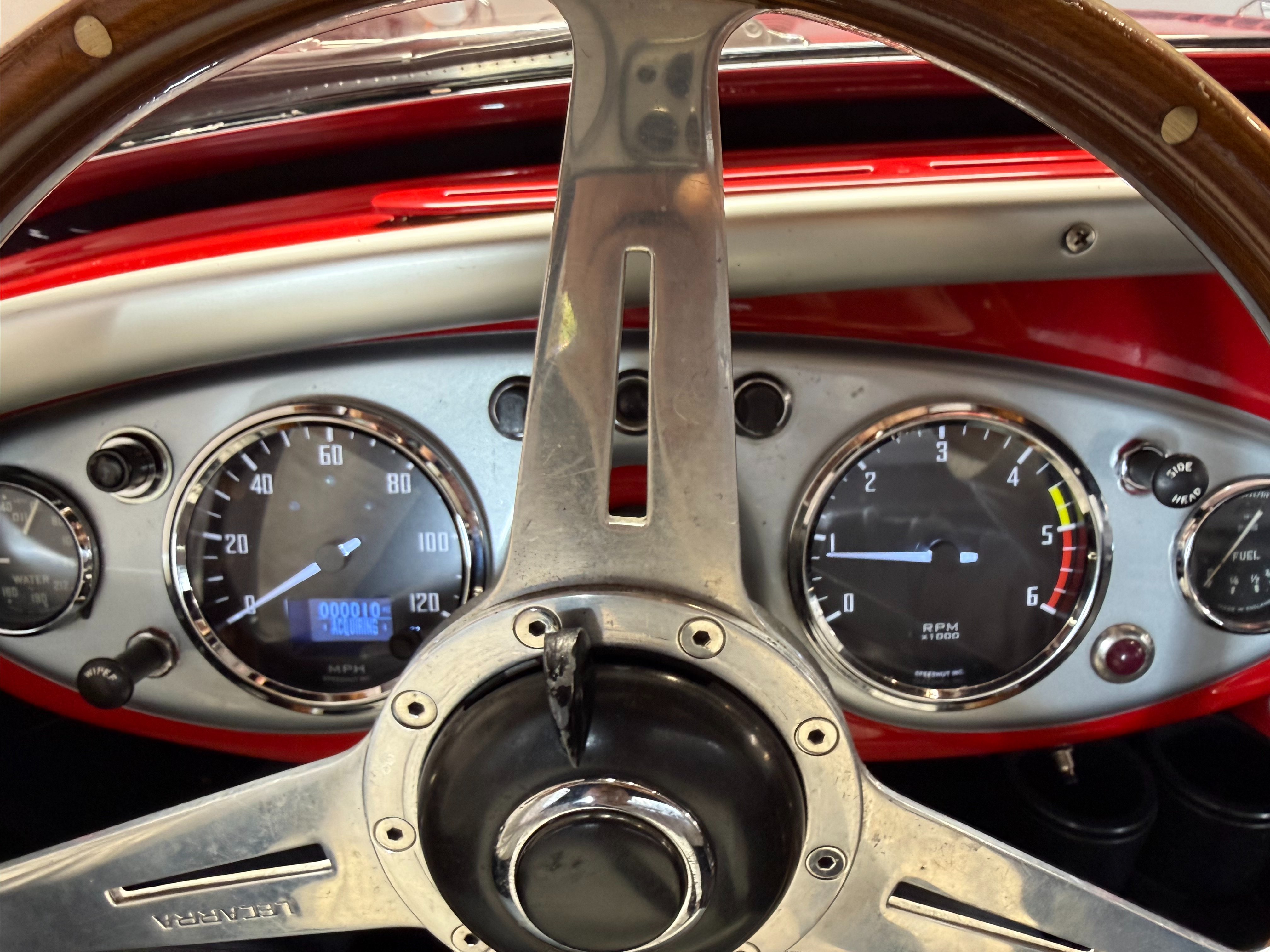

It took me a couple of years but I finally decided to come into the 20th century and upgrade the speedo--and tach as well--to electronic units. I finished installing the Speedhut 4" units today and though I only went out for a short test drive it was nice to see steady needles. Thanks for the push.

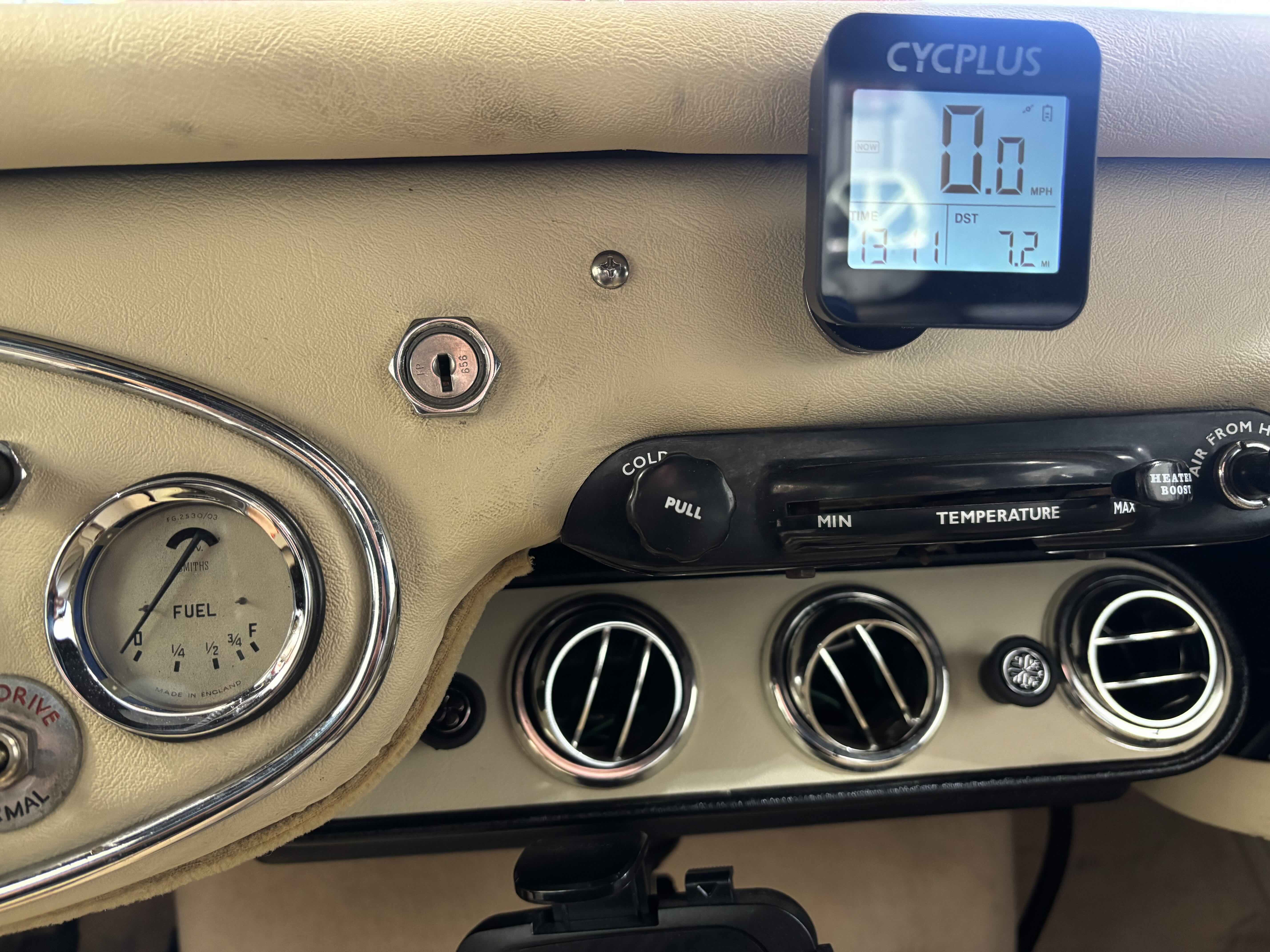

My solution was to just buy a bike GPS. $26.99 at Amazon. The mount is a Garmin handlebar stem mount that I added a steel disk. Behind the dash I glued a rare earth magnet. Goes up to 99 mph. It stays put just fine. I even did a couple of autocross laps with it.
Here's how the Speedhut tach and speedo appear:

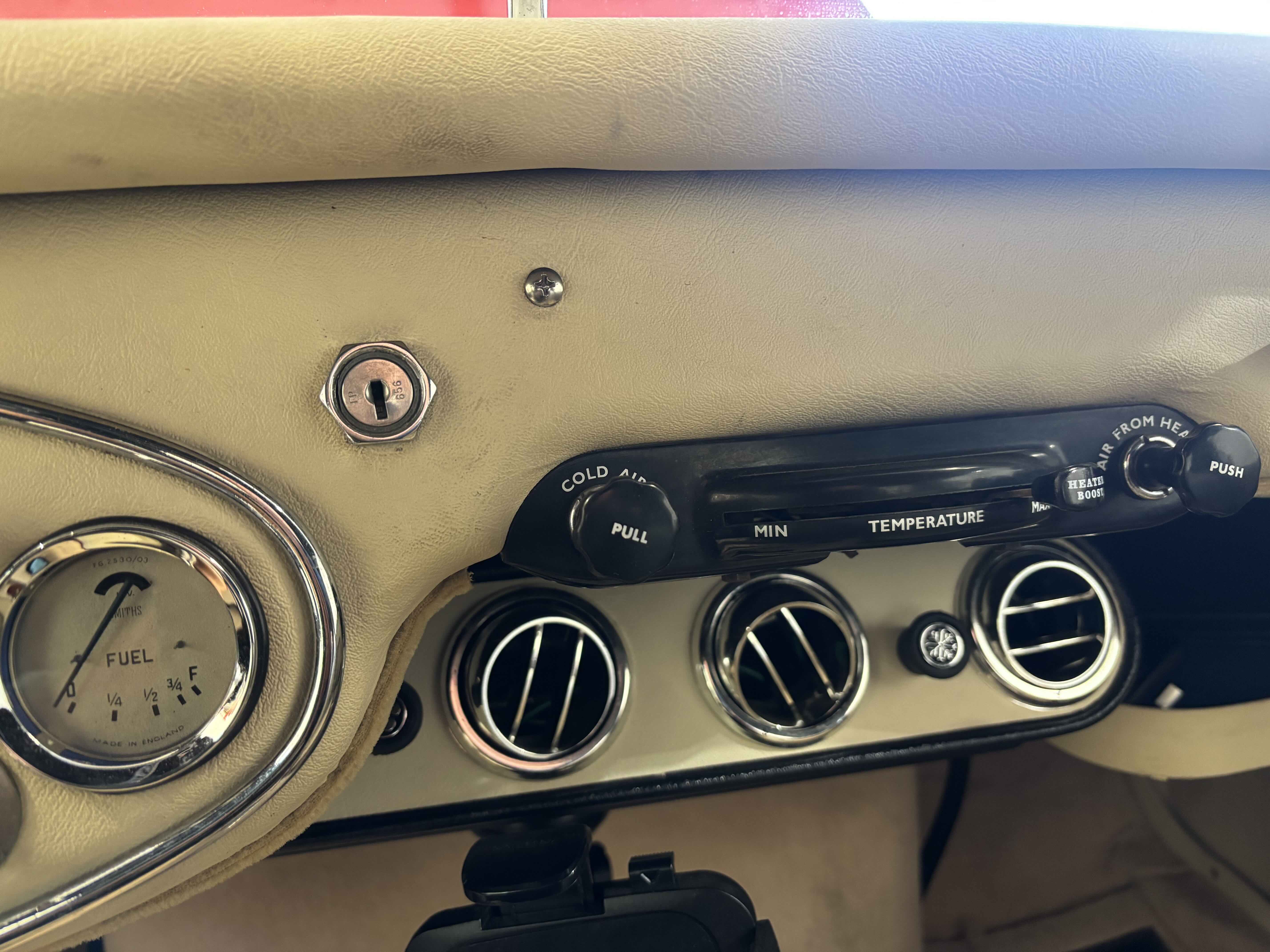

Speedhut also offers digital fuel gauges. I have one in my Mk1 Sprite (along with their electronic tach and GPS driven speedometer) and similar to those instruments, it very closely matches the original face of the stock Bugeye fuel gauge.
When I installed their new fuel gauge I also installed a new tank and sending unit. I could not be happier with the reliability and accuracy of all these instruments.
I installed their fuel gauge in my BJ8 and it works great. I opted for the full sweep gauge and paid $30 to have the double white lines with reference points at each level of gas. The low fuel warning light is adjustable to where you want it, I set mine for third of tank reading. The gauge reads very smooth and doesn’t jump around like the original. LED lighting too.

BTW I went out for a 75 mile ride last weekend and it was a pleasant change to see the needles in both the new tach and speedo rock-steady.

Hi Michael,
I still have the same tank sender. I just soldered a flexible metal wire strand to the sender to make a good solid sending unit connection on the advice of a good Healey friend. I’ll see if I can find the photo to post.
