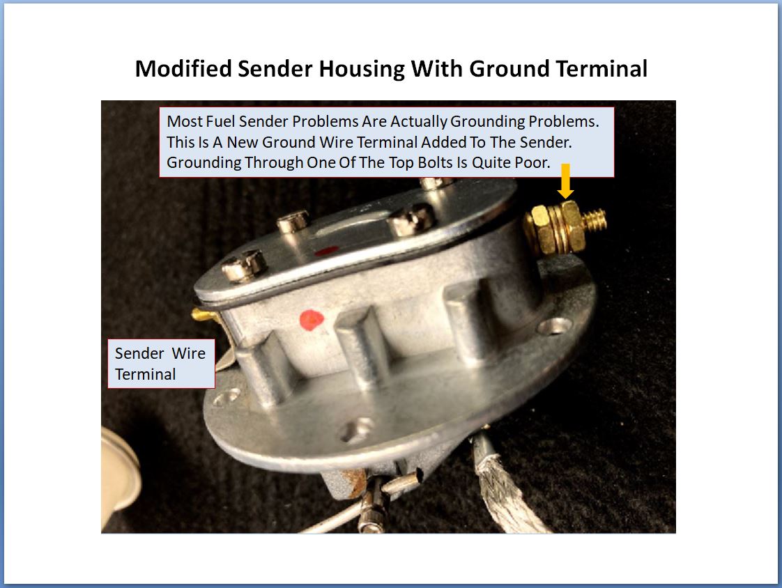

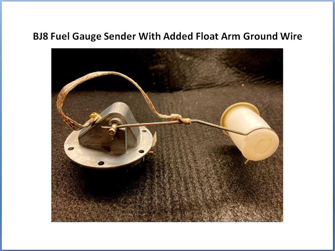

Patrick, In post #23 above I linked to Michael Salters grounding wire (with picture) - is that what you did?
I think most of us followed Michael's recommendations for grounding the fuel sender, with maybe slightly different approaches. But he paved the way.

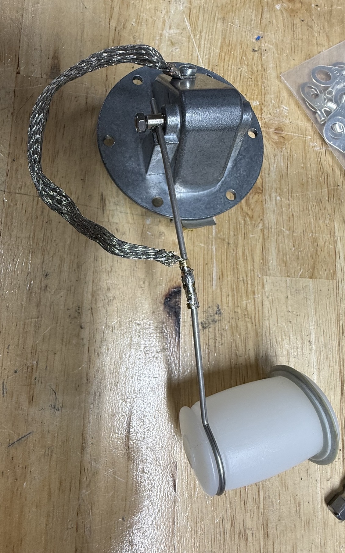

I did what you did and I believe you sent me a photo when we were both installing the speedhut fuel gauges. I went ahead today and installed my NEW sending unit grounding wire. My old unit was very similar to my new unit and I decided to redo it as a spare. The speedhut gauge was always reading smooth and accurate with no jittery jumping around. Here is my NEW unit and I’m going to use the new rubber gasket instead of the cork one.

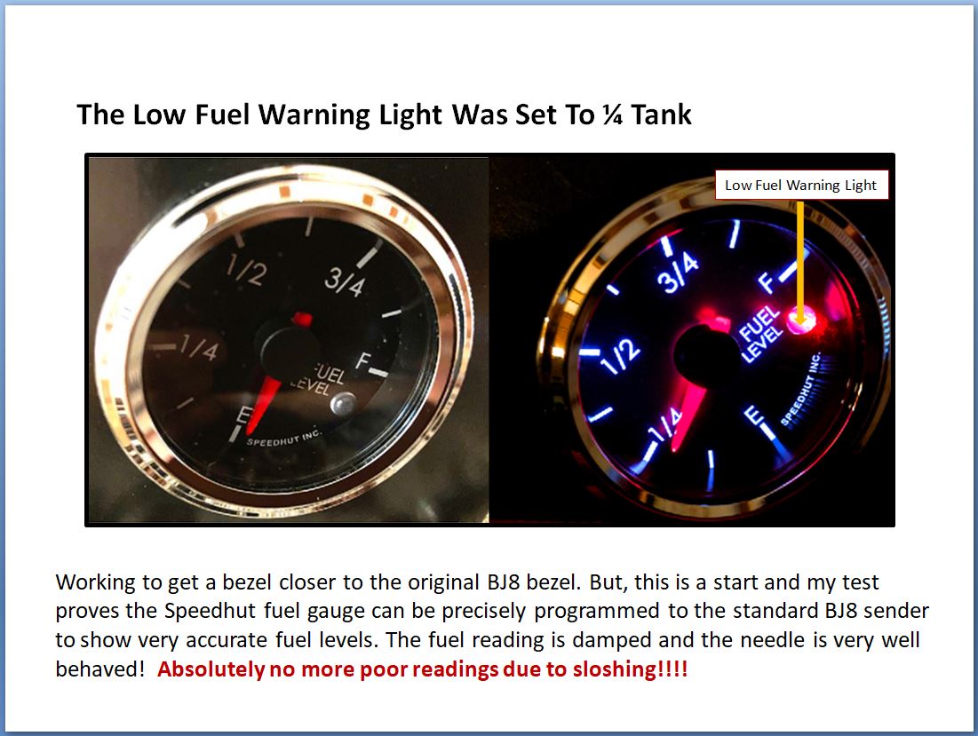

I believe Patrick recovered some of his pictures and emails, including working with Speedhut to calibrate gauge lighting to match the BJ8 lighting.
Hopefully, he will discuss this. Also, working with Speedhut, his bezel match is better than mine.
The slide shown below was part of the initial Healey sender calibration and gauge damping test.
