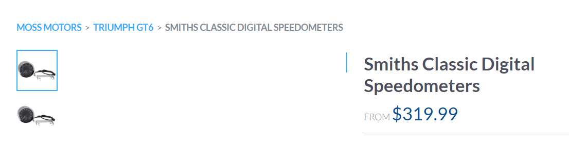

I am talking about a Smiths Digital Speedometer. It uses a Hall Effect Sensor, which senses something like a drive shaft bolt that passes by it. Moss sells them, although I they have been on back order for 1-2 months. I think they make them for a whole array of cars. I have used this type of Speedometer in a couple of other cars and they worked extremely well. Never used the Smiths, so hopefully they are as reliable a the others
See below
Oh, right. Thanks. Those are slick.
