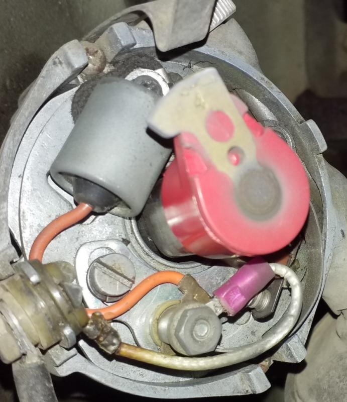

Trying to help a friend with his BN2 running very rough. New condenser, wires, coil, etc.
Do their distributors use an internal ground wire between the movable plate and side screw on the distributor chassis? Moss catalog seems to show it, but has no listing.
A picture would also be very useful.

Yes they do. I don’t have a picture, but one of the AHASC drivers had his come loose on a drive with us and reconnecting it solved his problem.
roscoe
Re: 100-4 distributor internal ground wire - does it exist?
The wire is black and in the upper left. It has to be thin and flexible. 20210220_130952_copy_891x1031.jpg
Thanks guys -
Ground strap didn't fix the rough running - he's flatbedding it to the mechanic.
Will post a followup when there's a resolution.
