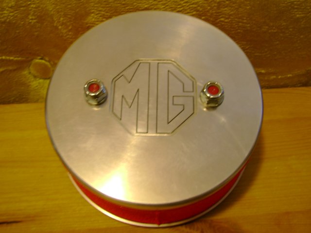

it was Christmas again when I got home tonight!
I'll get more pics this weekend while I'm strapping the HS6 and this filter to the car /bcforum/images/%%GRAEMLIN_URL%%/laugh.gif
Here's the air filter that I ordered from SU-Filters.com

CLASSY!!! /bcforum/images/%%GRAEMLIN_URL%%/laugh.gif
