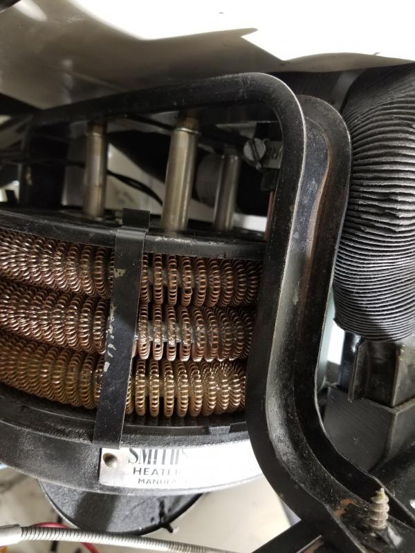

If the motor works but you have a bad core there is a replacement core available. It is the same diameter but a bit thinner. so some modification is required.
I got my replacement core from Holden Classic in the UK. It comes with shorter clips to hold the heater together.
The repaired heater works great.
David
