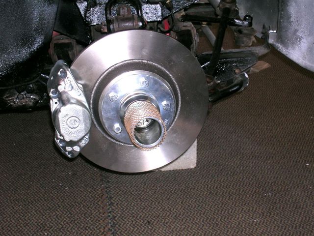

..I put on the Welch kit on my BN1, worked just fine, just make sure he sends the right bolts, he sent non british bolts for some reason, did we ever have a go around !!!
I have a non stock master cylinder, but nothing very new and all seems great, heck of a lot better than the drums.
Since I have a Chevy on mine, maybe I should have gone more exotic, but then again I wanted to keep it simple and easy.
