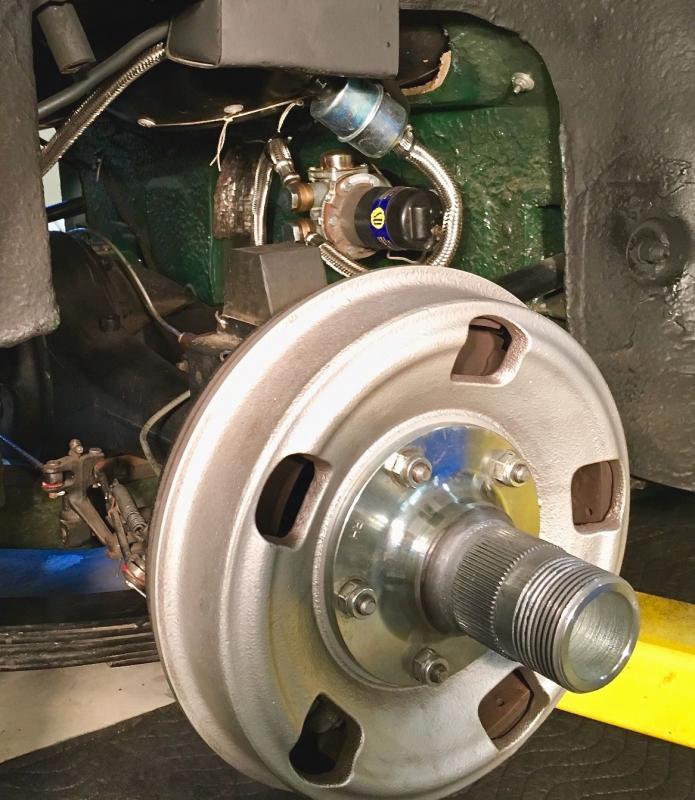

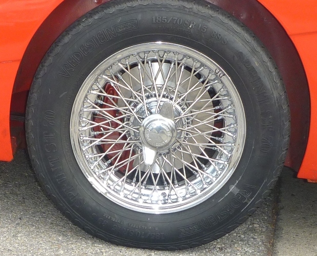

I have rear discs on my '57 vintage racer, but find the drums provide plenty of braking power with the right pads on my '65 Bj8 for street perfromance driving. I did upgrade to balanced and vented drums which also eliminated the scuttle shake that occured at 60 mph.

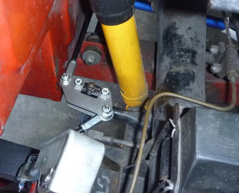

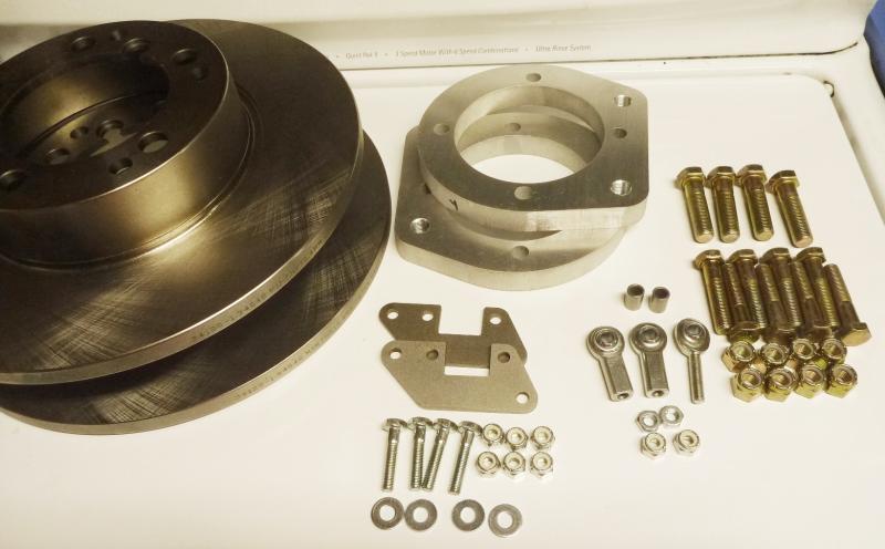

John, Thanks for the mention. Since it's relevant, guess I'm allowed a mild self-plug.
The kit's the most complete; the installer needs to supply their own calipers, e-brake rods, hard lines and proportioning valve.

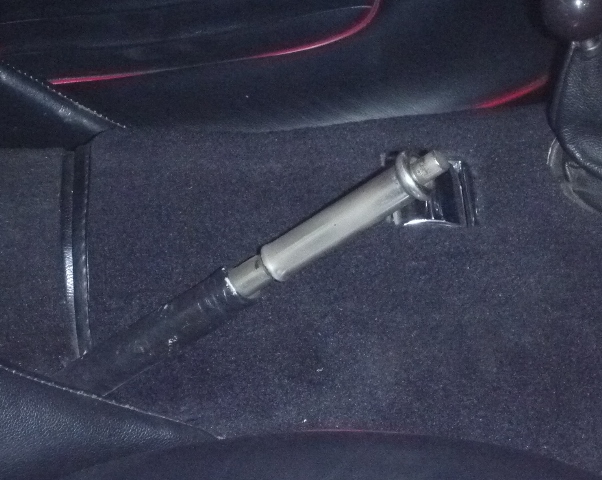

Nobody asked me, but that's never stopped me before ... I have/had several cars with 4-wheel disks. None of them have, IMO, anything more than barely adequate parking/emergency brakes; both my Healeys, with the big drums in back--front, too for the BN2--have excellent parking/emergency brakes. Just sayin' ...
With the stock setup, the rear drums are true emergency brakes, in that they will actually stop the car.
John Turney and I (and some others) have added dual master cylinders to divide the fronts from the backs, giving an emergency braking setup.
My adapter plates augment the e-brake force and give a better e-brake handle angle.
