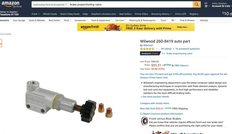

Here's the method of adjusting a proportioning valve:
Method was suggested with the car on jackstands:
to have an assistant lightly gradually apply the brakes while you hand-turn a front and back wheel.
Start with 7 turns down (from wide open) on adjuster; adjust to the point where front brakes just locked and rears braking but still moveable.
If your Summit valve looks like this, that's your answer:

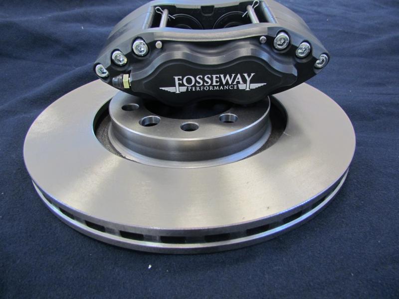

FWIW ... regarding the front brakes...I recently bought a Fosseway disc kit which has vented rotors and 4 piston aluminum calipers. This is the first kit I have seen that has vented rotors for Austin Healey's .... there may be another that I'm not aware of but I couldn't find one ... the Fosseway components are beautifully made. The brake experts that I communicated with told me that the "vented rotors" were a huge improvement over solid rotors. These will be going on my current BJ7 project car. Fosseway brakes S50 1713.jpg
