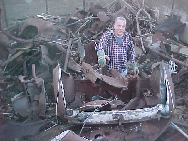

you mean to say some of you guys ever at any time any were drive slower then 80m.p.h ???????/they do that on the small narrow side streets here in sunny connecticut.check the attachment to see what happened to my car. /ubbthreads/images/graemlins/crazyeyes.gif
