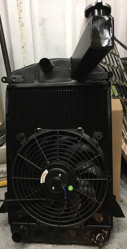

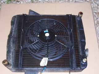

I prefer brackets, even though homemade

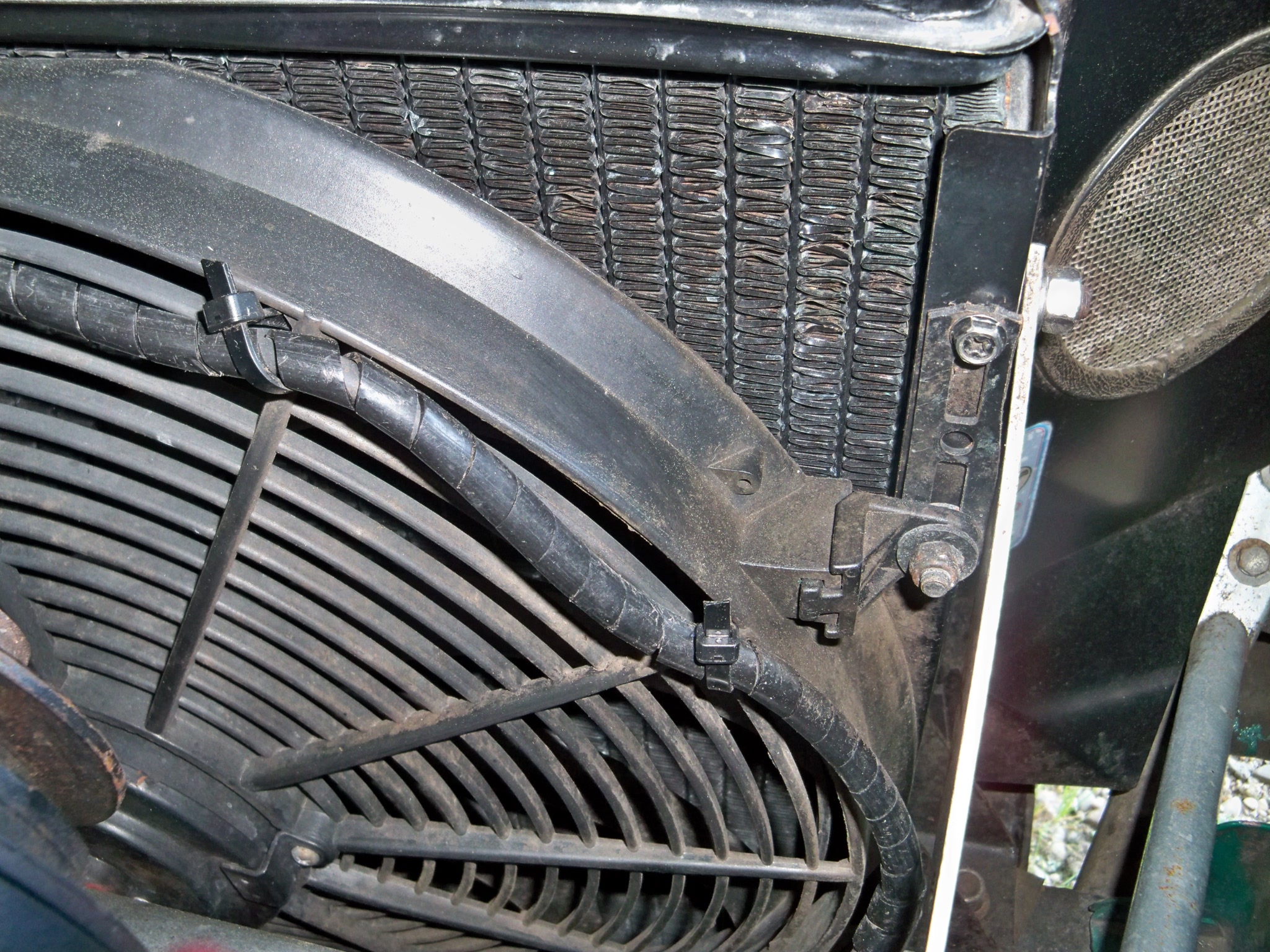

I make brackets and fasten to surround or frame. Used to mount thru radiator but did not like the vibration from the ties and they break over time from heat and age. Custom brackets look neater.

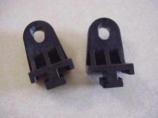

I use the through rad ties that have a conical spring for tension.i also fit felt pads to the fan mounts that would normally rest on the rad. its the cheap pads you can get for the legs/feet of chars to protect the floors.
this type of thing
but if i was starting again i probably would go for a fixed bracket
but I'm not rushing out to change anything.

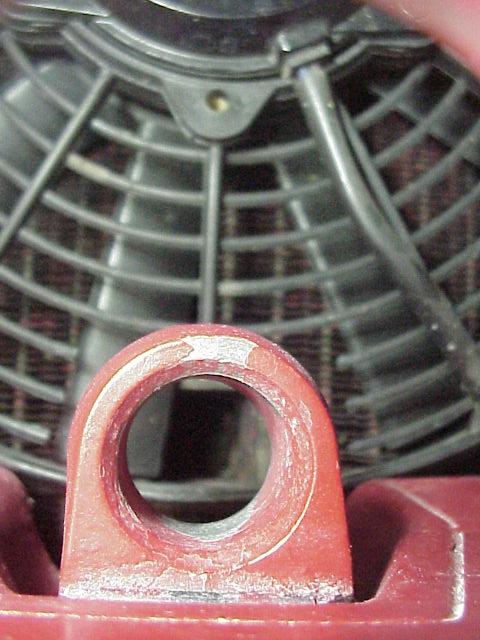

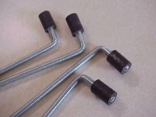

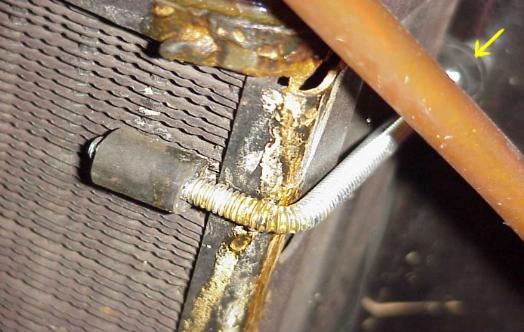

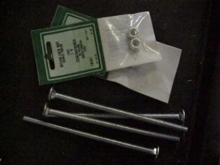

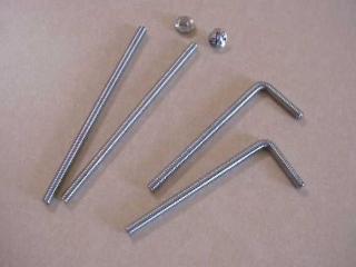

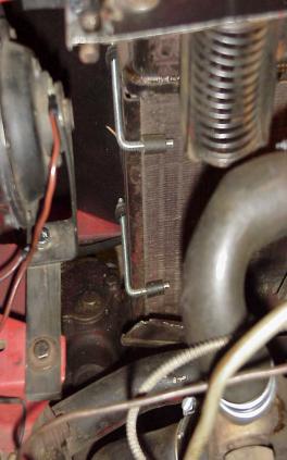

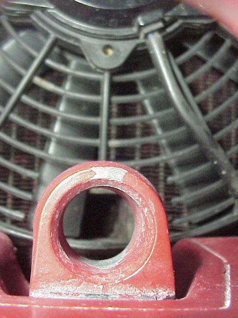

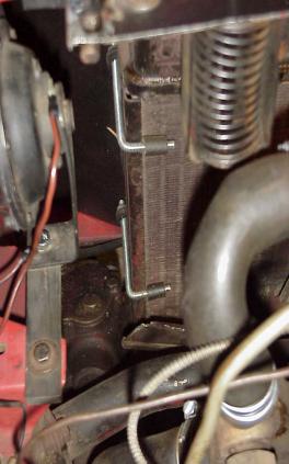

I made no-drill no-weld brackets by decapitating some long bolts, bending into an 'L' and using short bit of fuel line to protect and grip the radiator body. Had to slightly oval the holes in the mounting ears:
Did this on both a TR3 & 4 though I finally abandoned the electrics and went with tropical fans.
On the 3 I was able to preserve use of the hand crank by removing one rib from the fan cage:
View attachment 69725View attachment 69727View attachment 69728View attachment 69729View attachment 69731
Very clever indeed. Thank you
