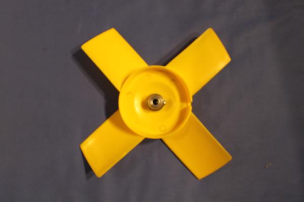

Metal clip? We may not be talking about the same fan. Here's a pic of the late MGB fan. It has a metal collar with a set screw that fits over the motor shaft. The shaft has an indentation where the screw meets it. The one I'm trying to remove has the set screw already missing, but the metal collar is stuck to the shaft and doesn't want to slide off.
Ah, different style fan. Would soak if for a few days...problem with the missing set screw letting more moisture in. The shaft on the motor is soft material, so take your time.
