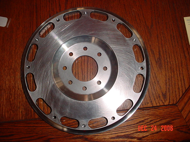

The inertia of the flywheel/clutch combination depends greatly on where the weight is located. The further out from the center of the flywheel, the more effect a given weight has. Weight that is located closer to the center, such as the clutch, has less effect on inertia.
For an example, see the attached pic of my new flywheel which has major weight reduction near the outer edges.

Dave, I assume that is a Denis Welch Flywheel. Are you happy with the performance? Still have sufficient low end torque? How much lighter is it? Bill Bolton took 4 lbs off of mine.

Hi Lin,
Yes, it's a DW flywheel. I don't know how much your flywheel weighs to begin with, so I don't know how much it now weighs. Different models had different weights.
A stock Hundred Four flywheel weighs 40 pounds. Mine had been reduced to 30, no noticeable difference. The DW wheel weighs 14 pounds & 26 pounds total with the clutch.
I don't expect it to hurt the driveability much, but it will be different. Remember, this is a very long stroke engine, 4 3/8" to be exact.
I'm raising the power peak rpm from 3,800 to 5,400 rpm. With the compression ratio increase from 7.5 to 9.7, it will still have more torque at 3,000 than the original engine.
The original engines had crankshaft problems above 5,000 rpm. I'm using a DW billet crankshaft & Carillo style rods to keep things together at the much higher rpm that it will be running. With the ATI friction type front damper, DW says that the combination will reliably turn 6,500 with ease.
A truck engine no longer. Haven't got it all together yet so I can't say how the combination will work but I expect it to be pretty good. Not intended for neighborhood cruising.

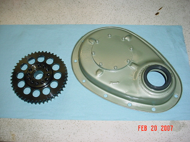

Hi Lin,
I'm using the DWR-1 cam, 268 degrees duration. The original cam is 230 degrees. Attached a pic of the adjustable cam sprocket & cover.
D
