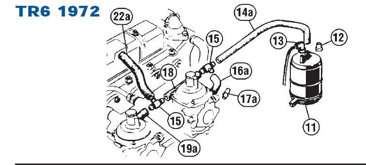

The carbs you have would work well enough, I think. Run the servo vacuum line to the big fitting in the intake manifold, then tee together the line from the rocker cover with the two ports sticking out of the carbs at an angle and the line to the carbon canister (two tees). Cap the distributor lines, set initial timing to 10-12 BTDC.
