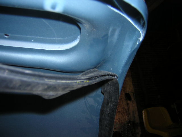

I bought a new seal and fitted it but something is not right, should the seal run down the flat edges on either side of the boot ? have i got it the wrong way round ? can't seem to get my head round it, unless i have the wrong seal.

Perhaps i'm just being daft, but the seal seems to snag on the two side edges of the boot where the edges are turned 90 degrees, i may have the wrong seal or perhaps just fitting it wrong, perhaps the picture may shed some light on it.

Sorry Rob, that doesn't look like any seal I've seen before.
Most when looking at the seal from one end are flat on the bottom and a "scoop" on the top. The flat portion is glued to the boot lid. That way the boot will seal when it is closed. I installed mine by first taping the seal around the shroud opening with the flat side facing up. Then I applied glue on both the flat side of the seal and on the boot. When the glue is dry, slowly and carefully lower the boot lid onto the seal. Now you can remove the tape from the shroud and lift up the boot lid and remove the remainder of the tape. Minor adjustments can be made but the bootlid should always seal correctly.
Hope this helps.
I'm not too sure from your picture but I recall that the seal goes all the way to the edge of the boot and does not turn in like yours. I also think you have the wrong seal. Mine is like a "U" with one side longer. It does not fit on the edge as yours appears to.

I'd better check i have the right seal first, it was ordered from a Healey supplier but woudn't be the first time that someone has sent me out the wrong part and totally confused me !!

Thanks for the picture, my seal doesn't look anything like that,i'd better re-order and try again.

It seems i have an uprated seal that is meant to fit round the rear shroud lip, there's the problem then.
