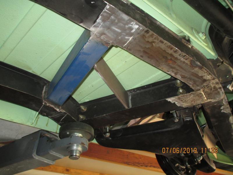

This is step 1.....welded in 65x8mm plate 900mm long to the centre chassis rails, together with additional bracing elsewhere.
More progress pics next week.

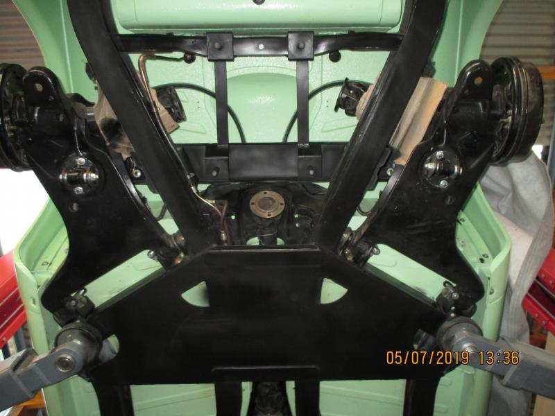

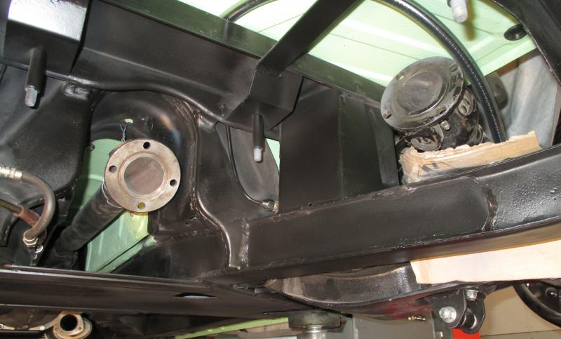

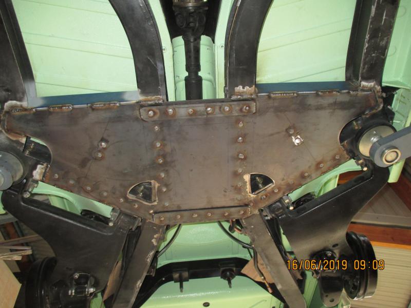

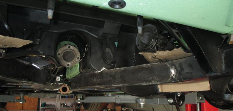

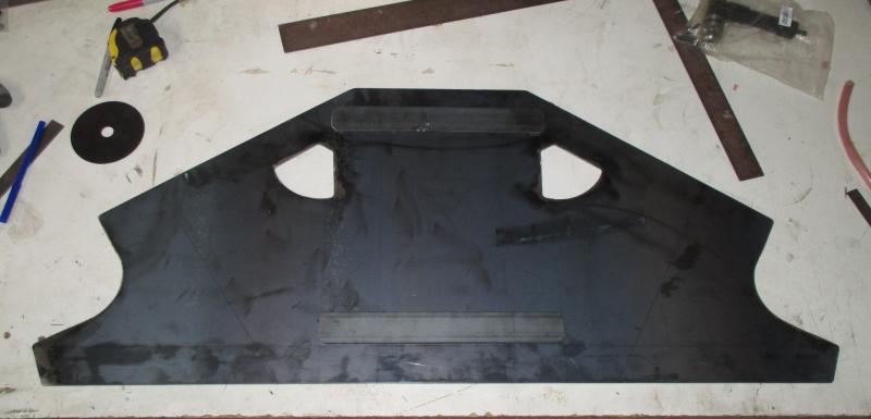

Step 2. Had a sheet of 3mm plate cut, and welded on. Maybe unnecessary, but why not..;)
Step 3. Welded in some 5mm thick strap braces linking the 3 bridges together.
Step 4. Boxed in the coil spring bridge supports.
Still have some chassis paintwork to complete.
