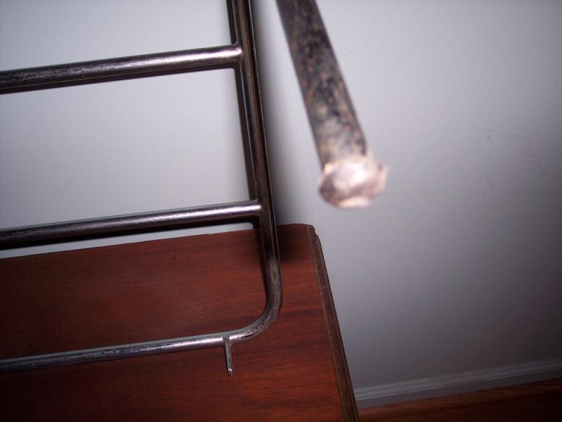

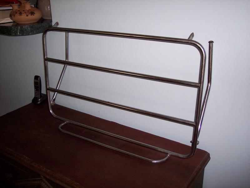

I have a boot rack that fits any 3000 or 100 series Healey. It is For Sale. Comes with mounting brackets and an installation sheet.. Listed on eBay...
