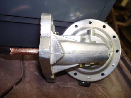

Mkutz: It seems like your going through a lot of trouble. Do you have access to a blast cabinet? If you do, these pump bodies clean up real nice and the pumps are very easy to disassemble.
Don Elliott
I have sandblasted my fuel pump a couple of times as Frank mentions. And also the one I carry as my spare. I also do it on other aluminium parts like the intake manifold, etc. for a quick and easy way to make them look new again.
AweMan
Glass beads it will not remove the aluminum, only the grunge!

I am with AweMan on this one. Glass works wonders and won't harm anything.
